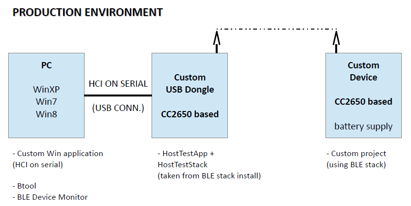

I'm going to develop a custom BT 4 device based on CC2650, and I want to develop a custom dongle too, in order to be independent from commercial dongles and win OS version.
Before starting the project, I would like to know if the development and production environments are correct or there are insuperable obstacles.

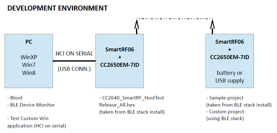

I will use CCS 6.1 on windows 7 to develop.
The development environment will be the following:
The production environment will be the following:
Will I be able to receive notification in my win app, if enabled on some characteristics, using HCI on serial connection?
