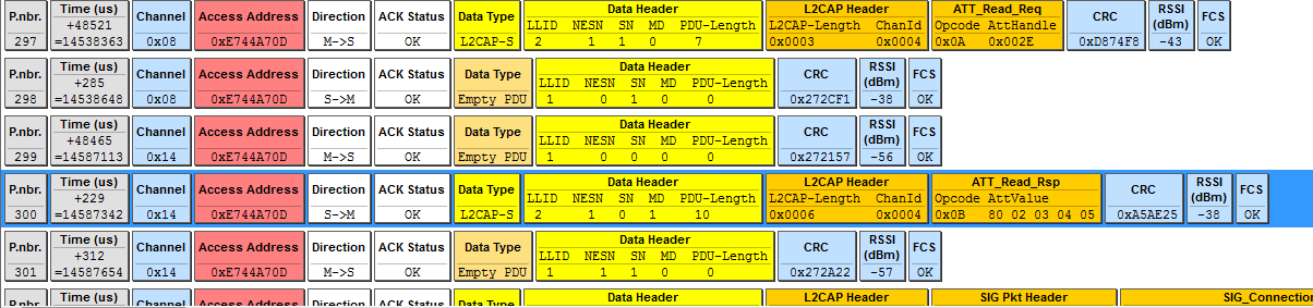

Hi Everyone,
I am using CC2650, loaded with SimpleBLEPeripheral example. Reading the default value for characteristic 5 is OK, I can get back the string 0x0102030405.
But when I change the initialise value to 0x8002030405 in SimpleBLEPeripheral_init, I no longer able to read the value (The android app is not display with any values).
uint8_t charValue5[SIMPLEPROFILE_CHAR5_LEN] = { 0x80, 2, 3, 4, 5 };
I actually this discovered this when working on characteristic 1, then test with characteristic 5 and same result.
