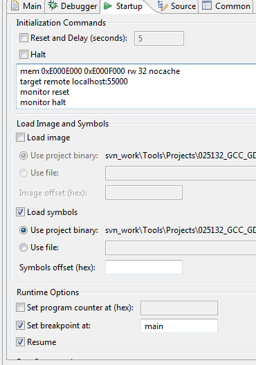

I am trying to debug simple blink project  (swra446.zip) in Eclipse with my CC2650EM (board rev. 1.2, chip rev. 2.2) and smartRF06EB board (rev. 1.2).
I set up debug configuration as described in the swra446 manual, but I can't stop at the main function and breakpoints don't work properly.
Programm always stops on the CPUdelay function from cpu.c:

    It has been an update of the GDB agent since the app note was written, which supports the monitor halt and monitor reset gdb commands.  If you are not already using version 5.1.642 you can get it from here:
    Then, in the startup tab in Eclipse -> Debug Configurations, do the following modifications:
    add initalization commands:
    'monitor reset'
    'monitor halt'.
    Check the following checkboxes under Runtime options:
    Set breakpoint at: main
    Resume
