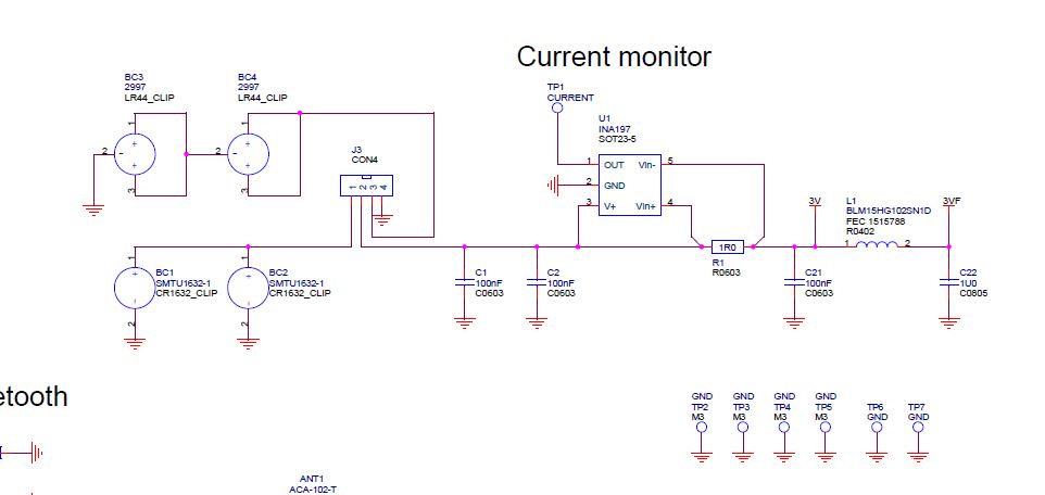

Hi all
This capacitor is 1uF. we are using it in a design where the CC2541 sleeps and wakes up very few minutes. The current pulse into this 1uF capacitor is 60mA which is rather cruel on  the CR2032 battery powering it.
Is it possible to reduce this current pulse? The capacitance could be reduced but the circuit won't like that much.
Any help would be gratefully recieved.
