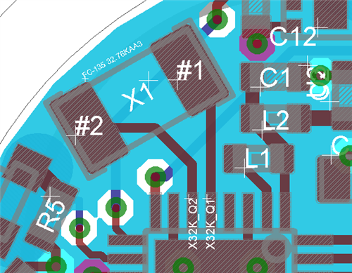

Hi everyone,
I come back on this problem because I really need to find the solution !

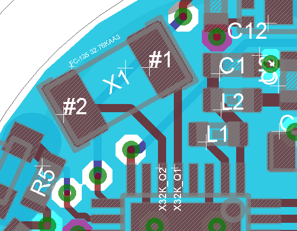

I use an external 32.768 crystal (FC-135) connected to X32K_Q1 and Q2 pins as on the picture. There is no capacitor next to it because I don't have much place (and it is already +- 20ppm, far enough). The CC2640 I use is 4x4mm (complete name : CC2640F128RSMT) version 2.2

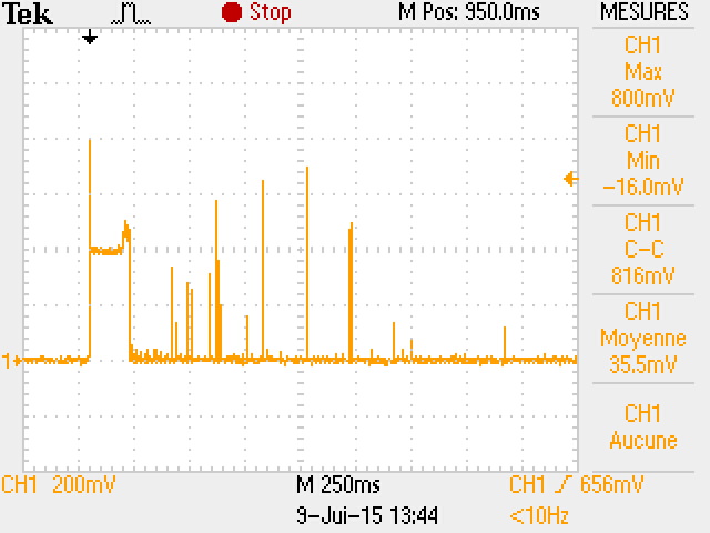

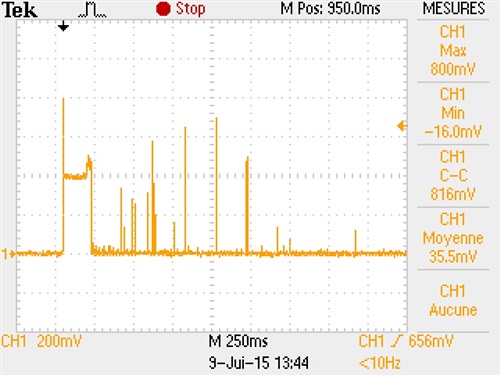

The problem is that the system does not go in standby mode and I have an offset of 1.5mA in Idle mode (picture is showing the current consumption during advertising, around 1.3mA/division.

  • The 32 kHz oscillator will not work without external crystals. The minimum crystal load cap for the 32 kHz crystal is 6 pF.
    Cheers,
    Fredrik
  • And you should not have signal traces underneath the RF circuitry btw.
  • Why the oscillator couldn't work without crystals ? The 24Mhz don't have problems without them... is it proper to low frequency crystals ?
    I will really have no choices about lines under RF circuitry if i have to add two capacitors next to the crystal :(
  • That is because the 24 MHz oscillator pins have internal load caps on the chip.

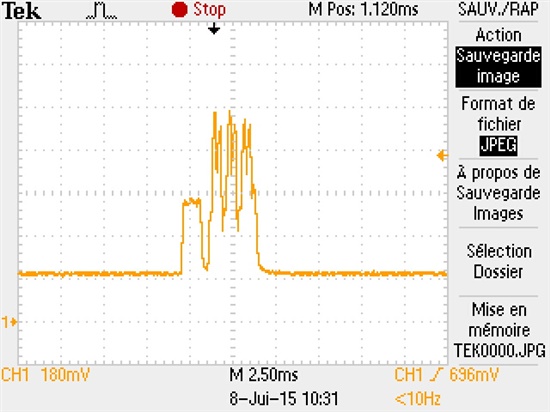

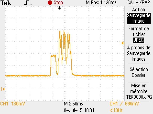

  • Ok so now the standby current is ok (I put two 12pf capacitors), but the system is restarting before advertising, every time:
  • Can you post your schematic and complete layout?

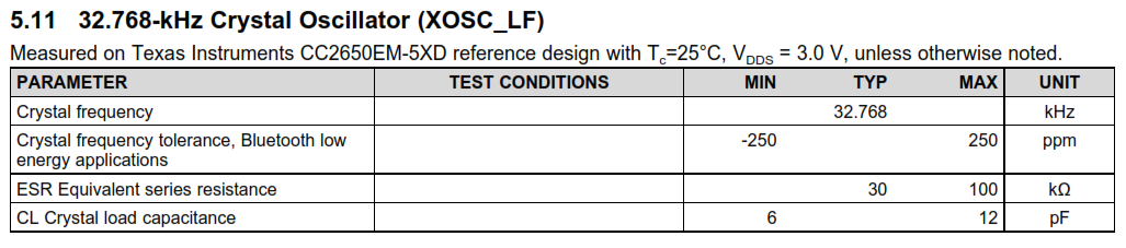

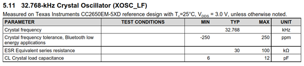

    On the CC2640 datasheet, there is a this specification about 32.768khz clock :
    It indicates that Crystal load capacitance has to be between 6 and 12pF. The official FC-135 is 7pF and mine was 12.5pF (FC-135 KA-A3 and not KA-AG...), and even with capacitors next to him (not needed to work with on a msp430 btw..), it will lead to a imprecise behavior.
    So for everyone using a CC2640/CC2650 : The LF XOSC chip must be between 6-12pf and must have 2 capacitors next to him.
    This is how any crystal oscillator is designed, the crystal requires a certain amount of load capacitance to work. In the case of the CC26xx the load capacitance must be in the range 6 - 12 pF. With properly sized capacitors the 32 kHz oscillator will work perfectly. If you see imprecise behaviour this can be caused by a number of HW design issues. Please ellaborate on what problems you are seeing. I would also very much like to see the spec of the MSP430 part you are referring to that works without capacitors.
