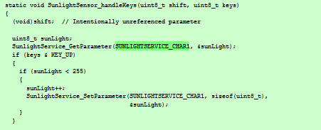

  • Variable SUNLIGHTSERVICE_CHAR1 is undefined in project but used in http://processors.wiki.ti.com/index.php/Tutorial:_How_to_Create_a_Custom_Bluetooth_Smart_Embedded_Application_with_the_CC2650DK
    Will it be SUNLIGHT_CHAR1 in place?
