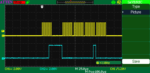

Hi Everyone,
I am interfacing M95M02 EEPROM with CC2541 using SPI in USART1. I am able to see the proper clk and MOSI signal as per settings but in MISO,there is no any signal.Before reading the data i am writing EEPROM with PIC microcontroller and verified it.the data are written properly. while reading with CC2541 on same location i am unable to get data.
Write  and read location is 0x0001,CH1 - Clk signal,CH2 - MOSI.
If there is any problem with code please intimate me.Thanks in advance
here my code,

  • Hi JXS, i found the problem,it is with "spi_send()"   and "spi_read" functions. we should not switch the CS line for every data transfer.it should happen only for a complete read operation or write operation.
    updated routine
    void spi_send(uint8 spi_data)
        U1DBUF = spi_data;
        while(!(U1CSR & 0x02));    //wait here upto the byte transmission
        U1CSR &= ~0x02;    //Clearing byte transimitted status for sensing next transmission
    uint8 spi_read(void)
        uint8 read_data = 0;
        U1DBUF = 0x00;        //loading dummy data in buffer
        read_data = U1DBUF;        //Get data from slave
        return read_data;
