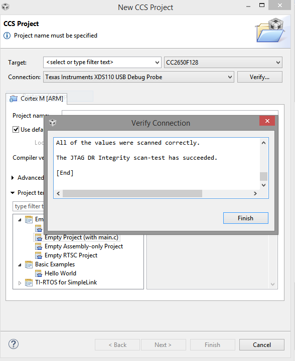

I plugged my SensorTag CC2650 and DevPack Debugger together and got them working in CCS 6.1. However, SmartRF Flash Programmer 2 v1.6.2 cannot seem to recognize if fully. It detects the XDS110 part, but not the CC2650.

I don't think it's in the FW Upgrade Mode since I've had that problem before and I solved it by following the CLI procedures from: e2e.ti.com/.../432761
After following the procedure, CCS was able to correctly detect the debugger:
Full output here: http://pastebin.com/raw.php?i=GKnMMQgW
There are two USB devices associated with the DevPack, a data transfer port and a debugger, so maybe only the debug probe is working and the data port is still stuck in FW Upgrade Mode?
