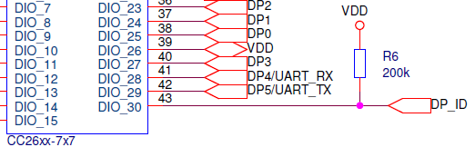

I am using SensorTag cc2650 hardware and CCS, and I am trying to read values from ADC. But, I get strange values. For testing I am trying to read pin DIO_30, that is tied to VDD. This is illustrated in the clip below.

  • Hi Arne,
    I suspect you are measuring on a floating pin and not the one you intend to.

    Pins in the AUX domains are mapped to AUX IOs (and not DIOs) so after disabling input/output buffers on DIO30 you need to connect AUXIO0 to the ADC itself. The mapping between DIO's and AUX IO's are found in "Chapter 11.8 I/O Pin Mapping" in the technical reference manual (SWCU117).

  • Hi Svend
    Thanks for answer.
    I have changed to AUXADCSelectInput(ADC_COMPB_IN_AUXIO0); as you proposed.
    Now I am getting more sensible values, but there is one more thing that worries me.
    Since I am using AUXADC_REF_FIXED as reference, I expect the value 4095 to represent 4,3 V (as mentioned in the documentation). DIO_30 are connected directly to VDD (battery), and I am getting 2610 as a value from ADC. Calculation of the voltage should then be (2610*4,3V)/4095. That gives 2.74V, representing the voltage on the battery.
