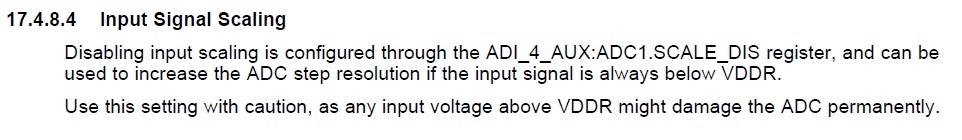

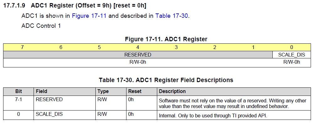

ADC fixed reference
Basically wanted to enhance resolution of internal ADC (range of input is not the constraint)
Lowering the reference voltage (< fixed 4.3V) is one of the way.
Using the 'VTRIM' settings (in REF1 register) is the right way for that ?
What "nominal voltage"  specifies in the VTRIM settings ?
