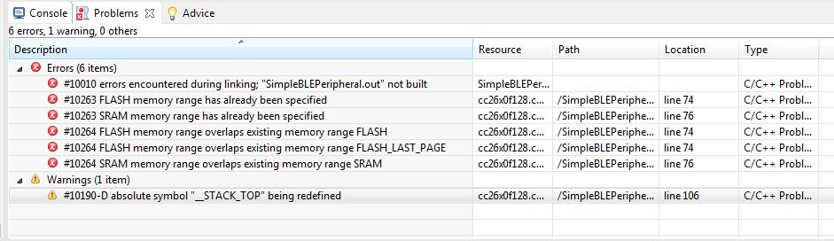

I'm trying to rebuild the SimpleBLEPeripheral Project after switching between ROM version from using the CC26XXWARE variable as described in the FAQ.
CC26XXWARE Rev 2.2--> C:\ti\tirtos_simplelink_2_11_01_09\products\cc26xxware_2_20_06_14829
CC26XXWARE Rev 2.0/2.1 --> C:\ti\tirtos_simplelink_2_11_01_09\products\cc26xxware_2_00_06_14829
Everything built fine before I changed these libraries, however i'm now receiving the following error when attempting to build for either revision of the device.
I'm seeing the following error.
I tried resetting FLASH/RAM boundry using the instructions in the SW Dev Guide Sections "3.12 Configuration of RAM & Flash boundary using the Boundary Tool" but that did not solve it.
I'm open to suggestions.

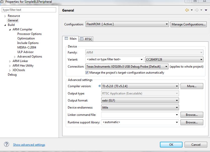

    Yep, we managed to get past this.  You are right, the CC26XXWARE does not cause this issue. Changing the Target Device in CCS add a cc26x0f128.cmd to your project file.  This command file competes with the existing cc26xx_ble_stack.cmd that is included in the project.
    Removing the cc26x0f128.cmd fixes the issue.  Here are pictures of working and broken configs.
    Working Config (Default state of the project):
    Broken Config:
