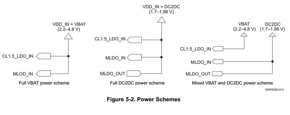

My customer would like to use the CC2564 in the full DC2DC power scheme with VDD_IN = 1.8V. Current consumption for EDR full throughput is listed at 41.2mA for VDD_IN = 3.6V, can you please provide this value for VDD_IN = 1.8V?

    It turns out my customer was looking at an old version of the datasheet (last updated October 2013). In that version of the datasheet the full DC2DC power scheme is described in detail to optimize for power consumption instead of output power. This does not show up anywhere in the new version of the datasheet on the TI website (updated January 2014).
    Is the full DC2DC power scheme still supported on the CC2564? If so, where can I find documentation on it? What will be the power consumption for full throughput at VDD_IN = 1.8V?

    DC2DC mode is supported in the WSP package. The latest DS is from October 2013.
    Regarding the current consumption, we don't have such number unfortunately and they will have to be collected by the customer depending their specific DC2DC device.

  • Ok, I'm a little confused. The DS on the website and on ESP is SWRS121D, revised January 2014. Another DS my customer is using is SWRS098D, revised October 2013. These datasheets have conflicting information on the VDD_IN range, and SWRS121D makes no mention of the full DC2DC power scheme. Should I have him continue to use the October 2013 datasheet? Can we get the proper datasheet up on the website?

     I should have explained better in my previous response. The SWRS121D Ds is for the QFN package and the SWRS098D is for the WSP package. There are some differences between the two of them as you have already noticed. Given that the WSP package is only provided under NDA, the DS is not available to the public.
    I recommend using the corresponding DS. BTW, we will have an update QFN and DS in September which includes some minor updates.

    The current  consumption will depend on the external DC2DC that is used. Do you have some specific scenarios that you are looking for? I can check if we have some numbers for the scenarios that you are interested in.

    Here are some numbers:

    The idea of the DC2DC mode is that the internal LDO is by-passed and an external DC2DC device is used with better efficiency. Thus, better power consumption. The numbers are given at 3.3V to be able to compare apple-to-apples against the VBAT mode. Note that the current consumption is measured at the DC2DC input.

    Unfortunately, the Intel engineer is pushing hard for the current consumption separated at CL1.5_LDO_IN and MLDO_IN? Is this data available?

    We don't have this data. At this point, I think it would be better for the customer to measure their specific use cases. This way, they can get concrete numbers for their application.
