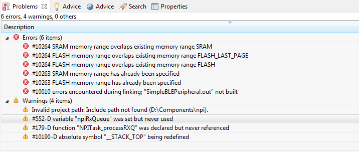

For the moment, i work with the SensorTag (cc2650) and i follow this link :
http://processors.wiki.ti.com/index.php/CC2640_NPI_UART_ECHO_EXAMPLE
I follow all of instruction, but i get this error message when i compile :
Do you have a solution ?
Best regards
  • Hello Steeve,
    Yes, I do remember your CC2541 project! I hope that is going well.
    For the CC2640, can you list the *exact* steps you performed on the default project before encountering this error? Did you change any project / processor settings to the SimpleBLEPeripheral project?

  • Hello JXS,
    Yes is fine, but now i try to porting my Serial Interface (like Serial Interface project cc2541), to new stack with CC2640.
    For the list, i have just follow the step from http://processors.wiki.ti.com/index.php/CC2640_NPI_UART_ECHO_EXAMPLE
    And i add 7 customs services on my project, and i call add command from each service into my simpleBLEPeripheral.c
    Best regards
  • Problem of compilation is solved. I started from a clean project and followed again steps. Now it's fine.
