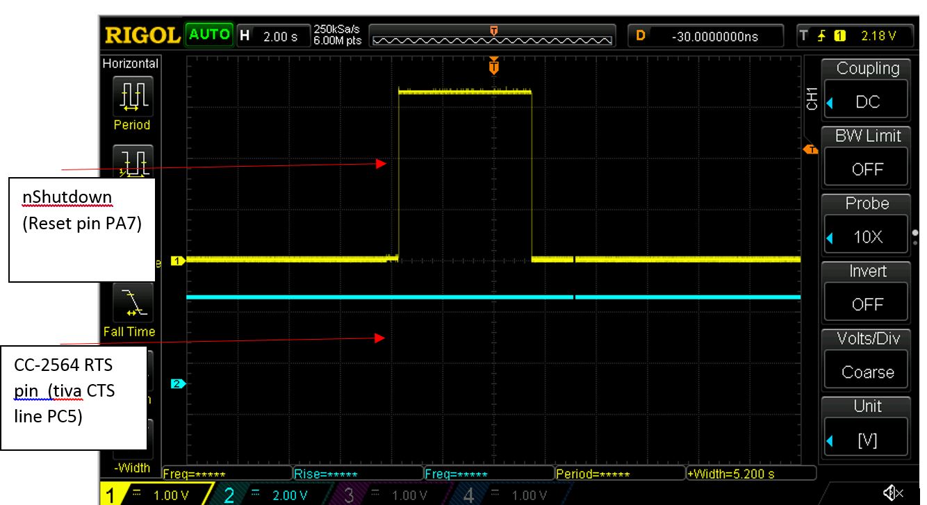

As you can see the nShutdown/Reset occurs but the HCI_RTS does not go low:

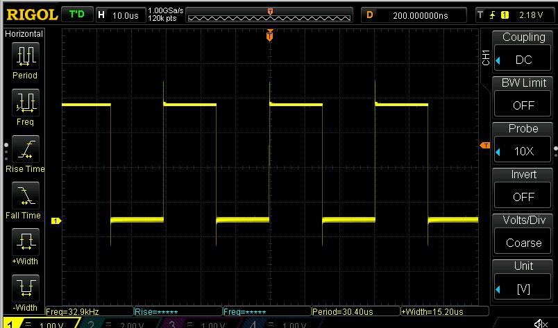

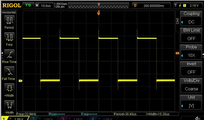

SloCLK signal, not sure if the is an issue because of ripple on the clock edges:
