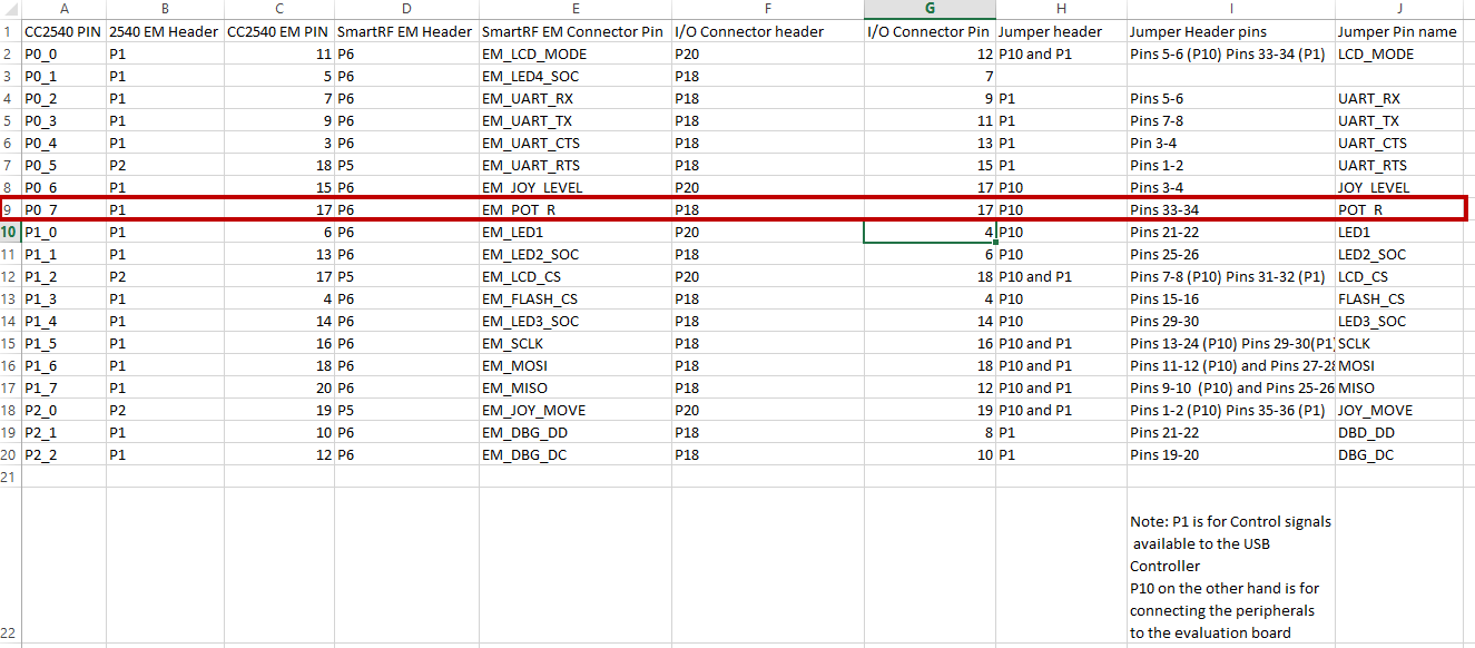

I bought a CC2540DK (SmartRF05EB 1.8.1 and a CC2540EM) and trying to verify that I can get to the GPIO. I have in past done a lot of arduino programming and I am trying to apply that knowledge to this board and failing miserably. Trying to get the CC2540 pin mapping to the GPIO headers is pretty complex but I think I have kinda got it. Here is what I mapped by going through the CC2540 chip reference, CC2540EM layout reference and finally SmartRF05 reference. I am a bit unsure if I got it completely right since P10 and P1 headers have some pins that are duplicated e.g. LCD_CS or SCLK, which confuses me on whether jumpers need to be removed on P10 or P1 or both?
Anyways, moving forward, if I  had to explain the following mapping table, I would say pin P0_7 on the CC2540 maps to Pin 17 on the CC2540EM which maps to the P6 connector on SmartRF which connects to P18 header on Pin 17. To make this pin accessible from the EM board and use it as a GPIO, I would have to take out the jumper on Pins 33-34 on pin header P10.
I did exactly this. and connected the positive terminal of a generic LED to this terminal. I connected the ground to the Pin 20 on header P20. I chose this pin because per the SmartRF and CC2540 manuals, this pin can supply up to 20mA of current which is needed to light up a small generic LED.
