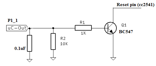

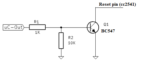

  • For resetting, I had tried to reset using hardware and IO pins by connecting P1_1 to base of transistor using 1K resistor and cc2541 reset pin connected to collector with emitter grounded. In software side i had configured P1_1 as o/p and set P1_1 = 0 in the very beginning of main() but this is leading to resetting the hardware continuously on its own. Can anyone please suggest me if i have made mistake in the circuit or if anyone can suggest some other way which can reset peripheral instantly and device start advertising?

    P1_1 does not have internal pull. During reset the pin will be a floating input and I guess the transistor can easily be turned on in this state. Try adding a pull-down resistor.

    4)I have even tried by connecting 10K resistor in between base and emitter which is grounded but then also it doesn't work. In this set up device doesn't start advertising but as soon as i remove the setup, it starts advertising. I think this happens due to transistor is triggered again as soon as its power recycled. uC-Out is P1.1 in picture

    I found some spike when i was power resetting which was resulting in triggering the transistor and hence system was resetting again and again. I had modified my circuit design and added one capacitor at the i/p to base.
    Now my circuit is resetting properly and advertising instantly but only drawback is its adding extra space to the circuitry for no reason. If soft reset would have worked fine then this extra circuitry would have been avoided. will try again to find if i can it do using soft reset.
