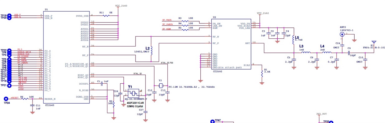

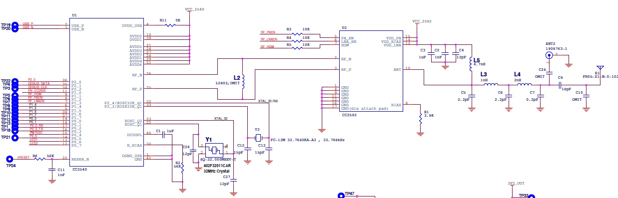

I am using BLE cc2540  with range extender cc2592 .. I have configured the cc2540 with the following code "
HCI_EXT_SetTxPowerCmd(HCI_EXT_TX_POWER_4_DBM);
// Set extended power
HCI_EXT_ExtendRfRangeCmd();

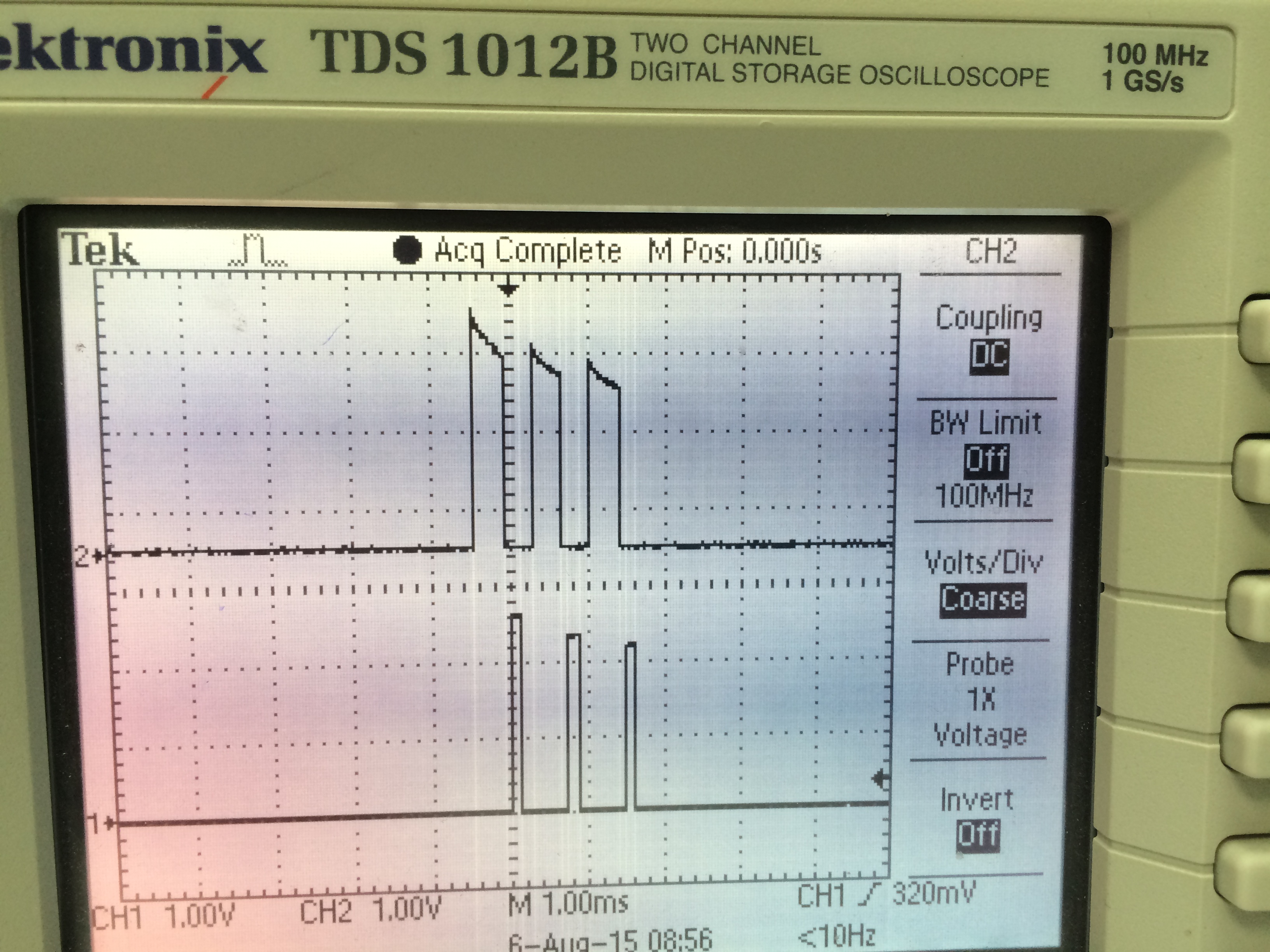

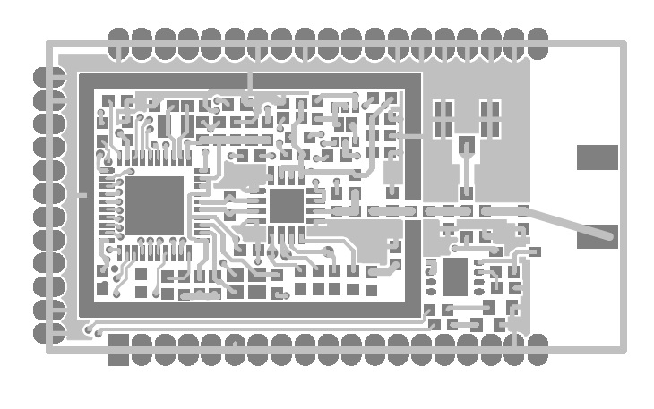

I see no effect of cc2592 .. I observed the 3 digital control lines PA_EN , LNA_EN, HGM.....       I see 3 pulses over 2ms  on each   PA_EN , LNA_EN ( not at the same time ..interleaved )  .. HGM  is zero all the time .. I am sending advertizing packets   at 100ms  intervals.  I should be seeing about 20dbm   output  but I do not . The output is the same as if cc2592 not in ...
Would someone please help :
A- OFFER TIMING OF THE 3 DIGITAL CONTOLL SIGNALS
B- THE BEST WAY TO TEST THE CC2592
