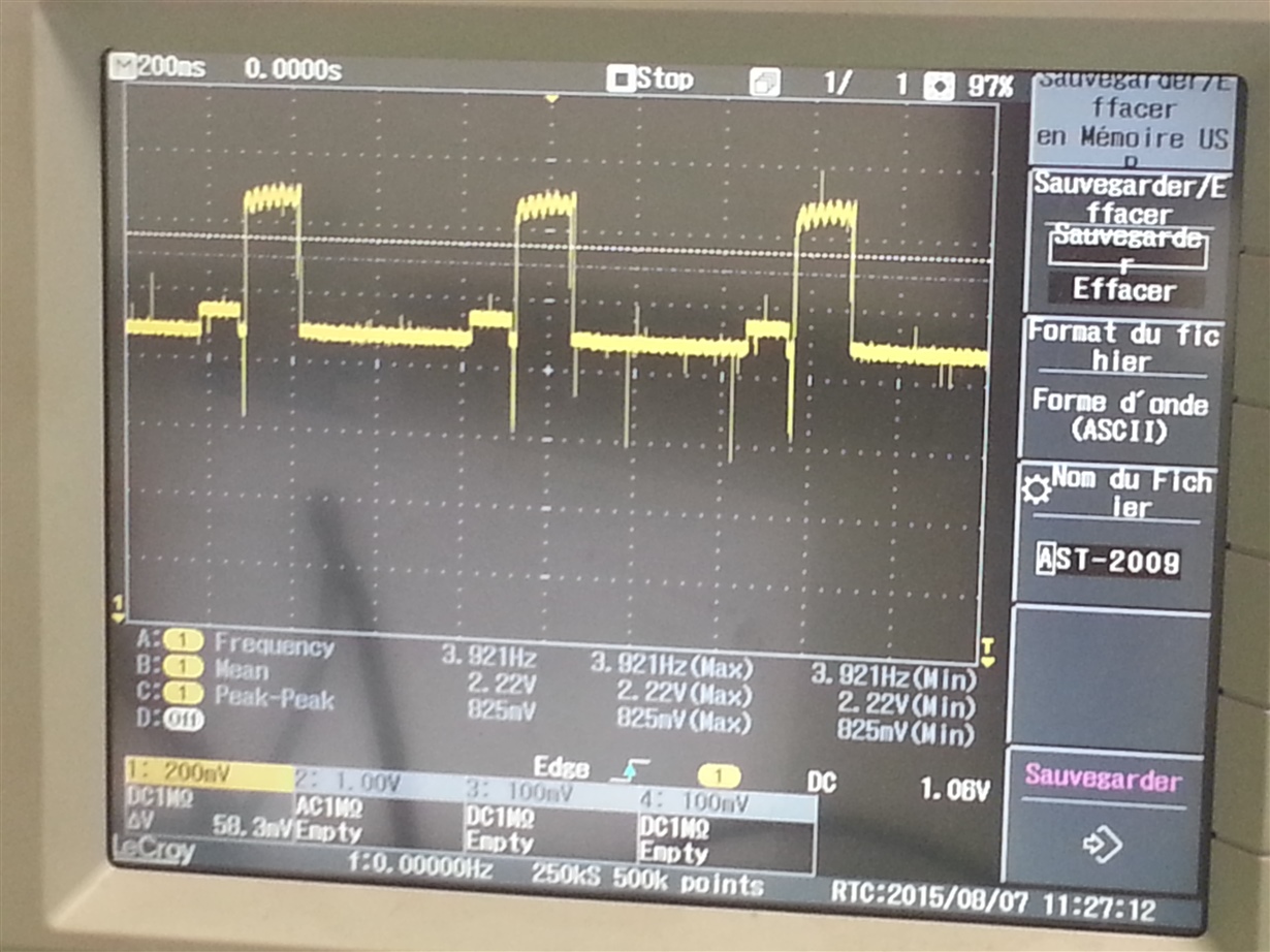

I'm using a custom CC2540 board, and my project is based on the KeyFobDemo project.

Then, here is my probem : the project with the oad feature (oad service, BIM, etc...) keeps resetting every almost 500ms (so i can't keep a ble connection with it),  while the project without works fine.
I found that with "HAL_LED=TRUE", there's no more resetting and i can connect to it, but then, the led pins are disturbed (by the led driver i guess).
Since i need to free the led pins that i'm interested in (P1_0, P1_1), i would like to keep HAL_LED=FALSE.
Any idea about the "reset loop"?
Gui
  • How is it resetting? Do you hit a breakpoint in main()? Is the reset line going low?
    Is this custom hardware or a TI reference platform?
  • It's custom hardware.  Here is the reset command line :
    Mainly, it jumps between 2.2V and 2.6V.
