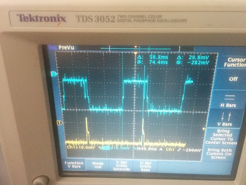

Attached are pictures of the oscilloscope when performing the following sequences:
Sequence 1:
1. beacon interval 150ms (yellow).
2. ble sleeps 100ms between discoveries (blue), i.e. wakes up ~50ms before the expected advertisement.
3. ble goes to sleep (enters PM2) right after receiving the advertisement.
in this sequence you can see that it takes a relative short time period (~10ms) for the power to drop after the ble receives the transmitted packet and stops its discovery phase.
Sequence 2:
2. ble sleeps 140ms between discoveries (blue), i.e. wakes up ~10ms before the expected advertisement.
in this sequence you can see that it takes a longer time period (~50ms) for the power to drop after the ble receives the transmitted packet and stops its discovery phase.
My Question:
In both sequences, the power consumption of the BLE is high for ~65ms.
I expected the power consumption to be much lower in sequence 2, since I use longer sleep periods and request discovery to stop immediately after receiving the transmitted packet from the beacon.
1. Did anyone else has encountered something familiar, and can please explain the logic behind this behavior?
2. Is there a way we can guarantee that the delay period prior to entering PM2 will always be short, as can be seen on sequence 1?
Thanks in advance,
Danny

    Have you looked at the RF traffic with a BLE sniffer? In the latter case it seems to switch to TX to ACK the package and then it stays in TX for a very long time.

    I looked at the RF traffic using a BLE sniffer - it is consistent with what is seen in the oscilloscope.

    What would be interesting to toggle a GPIO when you hit the GAP_DEVICE_INFO_EVENT case in simpleBLEObserverEventCB and actually call GAPObserverRole_CancelDiscovery. The scan duration is the same for the two cases, both at around 60-70 ms which seems a bit odd because that would imply that you cancel the discovery process at different times (relative to start of scan).
    • Could you compare this suggested signal  with your power plot for your observer in blue?
    • What scan duration settings do you use? (GAP_SetParamValue(TGAP_GEN_DISC_SCAN, u16ScanDuration);)
    Disable the halt during RF. This will make sure the CPU is running as normal during RF operations. In this case for when the receiver is running during the discovery process. Issue the following command to disable halt of the CPU during RX:
    LL_EXT_HaltDuringRf(LL_EXT_HALT_DURING_RF_DISABLE);
    I tested this and found the same behavior. As I suggested to you, I added a signal to indicate when the GAP_DEVICE_INFO_EVENT event ran in the callback. The duration of this lasted until the scan window was complete (i.e. for as long as the radio was in active RX) before it ended indicating that the processor was not running during this time. That is why i suspected the HaltDuringRf was the cause.
