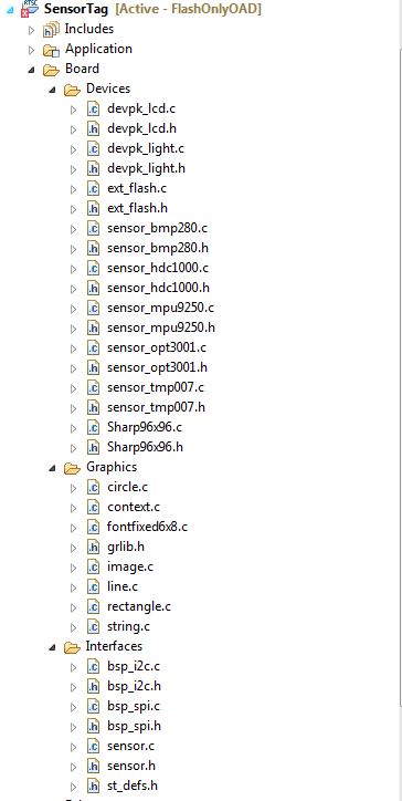

Greetings!
I am trying to get the CC2650 SimpleBLEPeripheral to work with the watch devkit.
I am using CCS, ble_cc26xx_2_01_00_44423 and tirtos_simplelink_2_13_00_06.
The Variant is set to CC2640F128.
I have removed the LCDDogm1286 code from the project.
I have set the new TI_RTOS_BOARD_BASE to:
${ORG_PROJ_DIR}\..\..\..\..\..\SensorTag\CC26xx\Source\Application\Board_patch
I have set the compiler includes to:
"${TI_RTOS_BOARD_BASE}/Interfaces"
"${TI_RTOS_BOARD_BASE}/GrLib"
"${TI_RTOS_BOARD_BASE}/devices"
"${TI_RTOS_BOARD_BASE}/CC26XXST_0120"
My board.c in Startup points to
    #include "CC26XXST_0120/Board.c"
The program compiles and executes as expected.  However when I call any board functions it fails to link.
undefined     first referenced
  symbol           in file
 bspSpiOpen    <whole-program>
 devpkLcdClear <whole-program>
 devpkLcdOpen  <whole-program>
error #10234-D: unresolved symbols remain
error #10010: errors encountered during linking; "SimpleBLEPeripheral.out" not built
>> Compilation failure
gmake: *** [SimpleBLEPeripheral.out] Error 1
gmake: Target `all' not remade because of errors.
**** Build Finished ****
What am I missing?
Any help would be appreciated.  Thanks,
Bob Roth

  • Hi Robert,
    When creating this project for CCS did you manually wipe out the old files from the Board directory? What I did, in addition to setting compiler includes, was delete all the old code under the Board folder and add in the new code from the Board_patch. My board folder now looks like this
    Also don't forget to add displayservice.c and displayservice.h to your Profiles folder if you haven't already. That should get your up and running.
  • Sean,
    Still a bit of a struggle but it works!
    Thanks again for all your help and support.
