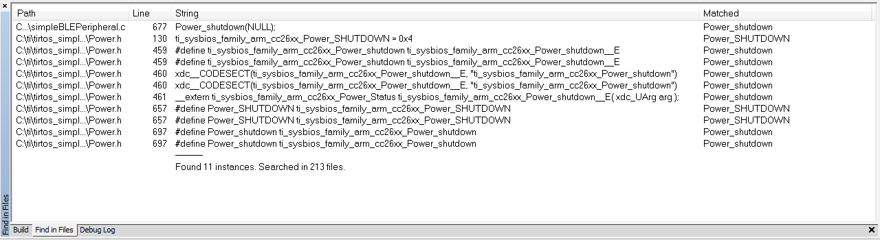

If i press switch for 6 times then its executing the "Power_shutdown()" function.LED Comes on permanently;

When Bluetooth is connected, if i execute "Power_shutdown(NULL)" Function then expected behaviour would be to Terminate all tasks,Stop BLE Link(Bluetooth link should get disconnected from BLE Monitor Tool)
and got to shutdown mode.
-This is not happening.
