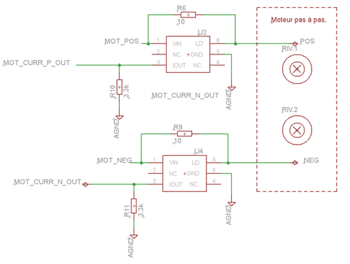

I have to manage a step-by-step motor in my project, and i measure the current through it to determine if the steps are a success or not. Four I/O are used with the sensor manager :
DIO 5 - ADC input for positive wave
DIO 7 - Digital output for positive wave
DIO 8 - ADC input for negative wave
DIO 9 - Digital output for negative wave
Theses I/O are not used by the main software (initialized pulled-down, input for adc and output for DIO7/DIO9)
The current is sensed through a 10 ohm resistor and amplified with a FAN4010IL6X from Fairchild semiconductor. Output resistor is 3.3kOhm. Here is the schematic : MOT_POS and MOT_NEG are the digital input/outputs.

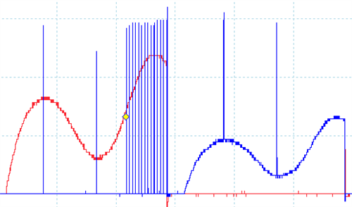

The current curve through the motor are correct and the motor is going well. But when I use the ADC, there is spikes on DIO5, even when I use the ADC on DIO8. Here is the code for the sensor controller :

The sensor will test the adc value after 1.8ms, 3.6ms and every 100us since 4.5ms. Then the output is cleared and n is inversed (and all start again). The curve looks like this :
The red curve is the negative adc input, and the blue curve is the positive adc input. We can see that on the red curve, glitches are coming from DIO5 when I do measure with adc. On blue curve, there is no test every 100us because the system detected that curve is false. It seems that the glitches will interfere on the reading and the blue curve will always be detected as incorrect.
I also tried by using asynchronous adc sampling, and i get a 1.2V offset on DIO5 !! The adc reading as, in this configuration, an impact on DIO5, unfortunately used this time for adc readings.
Any help is welcome, I don't know how to suppress this behavior or if I have to change my design ?

  • Hi, by measuring with another oscilloscope I can saw the same results.
    But by replacing the ADC reference by 3.3V, or something different that the VDD1P2V, glitches have disappeared and the amplitude of the blue curve is now the same as the red one. The ADC input on DIO5 changed every time I tried something with VDD1P2V as adc voltage reference.
