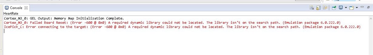

  • Error connecting to the target:
    (Error -600 @ 0x0)
    A required dynamic library could not be located.
    The library isn't on the search path.
    (Emulation package 6.0.222.0)
    Dear Michael,
                               There is no error while building the project. However, there are errors while debugging the project. Any comments?
    Keyshav
