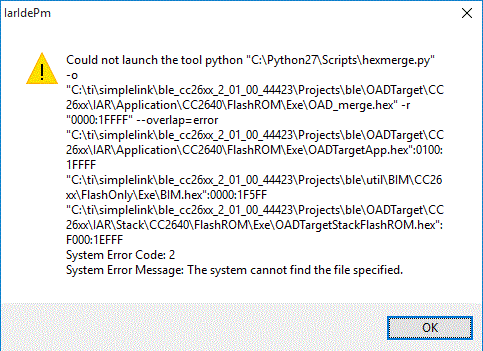

I'm following the instructions found in CC2640 BLE Developer’s Guide for OAD, and I'm running to a problem when the post build step attempts to merge the 3 hex files (BIM, app, and BLE stack) into one.
Here's the error message:
But I went through an manually verified that all of the files exist.

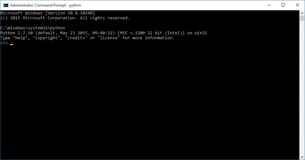

Python exists and is part of the path:

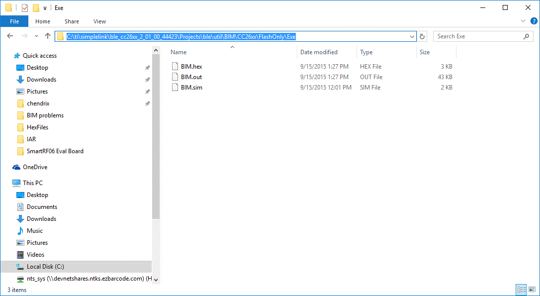

The BIM hex file exists and is in the correct location:

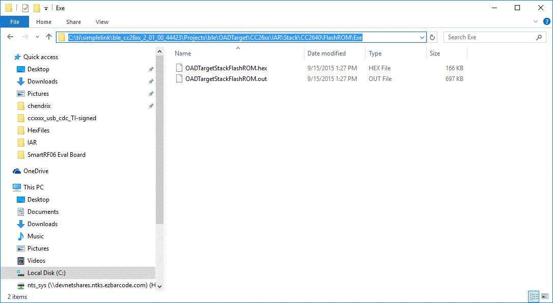

The ODTargetStackFlashROM.hex files exists in the correct location:
Everything exists where it should, or at least where I think it should.  In the original sample project, the *.hex file paths were all relative.  I changed them to hard coded, with the theory that one of the relative paths were wrong.  However, that does not appear to be the case...
