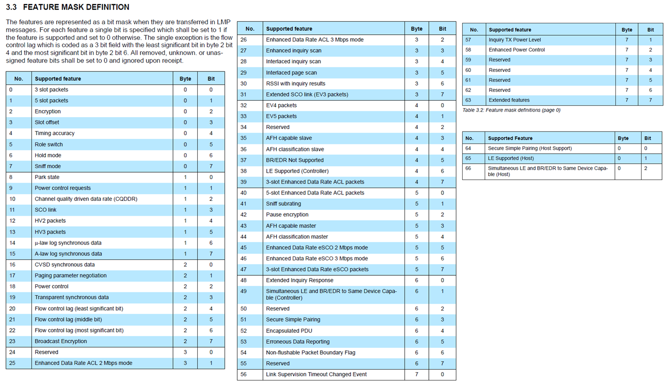

We are looking to the reduce power consumption of our device.  One of the methods we wish to investigate is to disable EDR and only use BasicRates for BT Classic.  Is it possible to turn off different modulations of EDR independently? I.E. If we only want to BT EDR2 and not EDR3.
Is there a Vendor specific command to do this?
