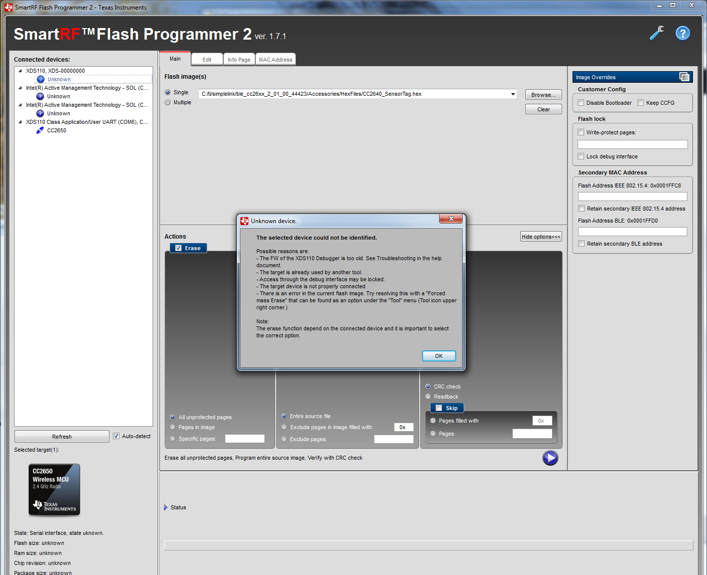

Got this error out of nowhere when trying to download my application:
"Fatal error: Failed to connect to the XDS emulator (connect ICEPick)...
(Error -241 @ 0x0)
A router subpath could not be accessed.
A security error has probably occured.
(Emulation package 5.1.641.0)
Session aborted!"
I'm able to program another sensorTag without this error though.
Is this sensorTag done or is there something I could do?
