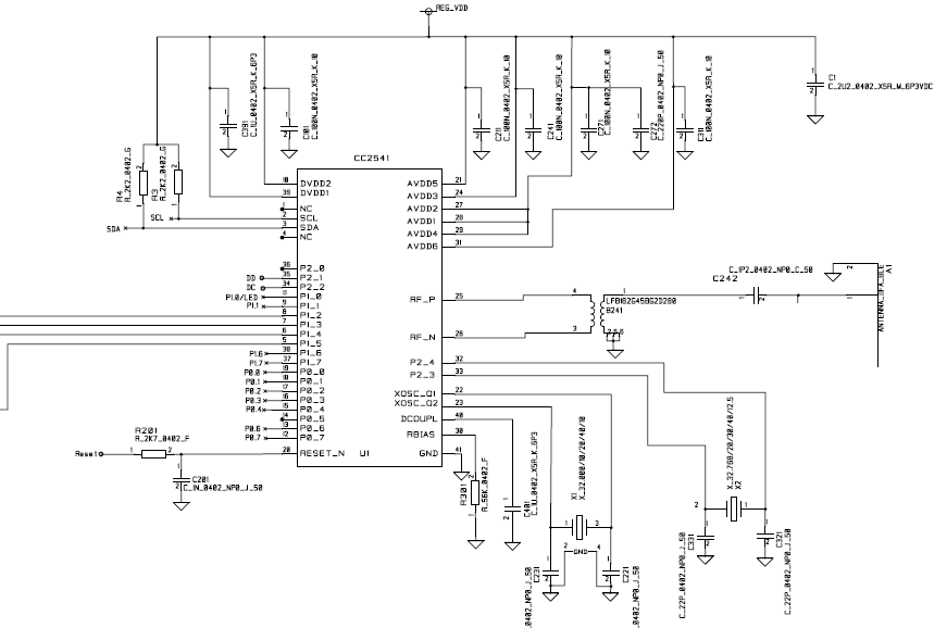

Hi All ,
     Has anybody faced bluetooth RF no signal issue ? now I am design a PCB board with bluetooth RF , I use cc2541 and cc2540 the RF circuit I  copy cc2541 sensortag , all the RF component (LFB182G45BG2D280 ) are same as sensortag's .  after I mounted the component , I can program it through smartRF05EM board , when I run my apps , but there is no bluetooth signal from my RF design coming . So I used smartRF Studio 7 to debug it , I also can't find signal . The picture below inside blue line  is my RF PCB layout  . if you find anything wrong or know how to debug it  , Could you please share with me ? thanks in advance ! .
    Which lines have you connected to your debugger? You need to connect DD, DC, VDD, GND and RESET. You must also make sure to power the board in addition to connecting the debugger. Have you measured the supplied voltage to your device and verified the voltages on the CC2541 power pins (AVDD/DVDD)?
    I could not find any errors in your schematic. For the Layout I have some comments given below. The rule of thumb is to copy the reference design as close as possible! This is very important. Especially anything related to RF and XTAL. But i could not find any direct clue to why your debugger cannot get contact with the CC2541 on your board.

  • Dear Eirik ,
    Thanks for your detail infos and suggestion , I will follow your suggestion .

  • Hi Shijun,
    It looks like you have connected DCOUPL to ground.
    Cheers,
    Fredrik
  • Hi Fredrik ,
    Thanks , actually I connected DCOUPL to a capacitor . Is that correct ? Thanks !
    BR
    Shijun
  • It should be connected to a 1 uF capacitor. In the layout you posted above it looks like pins 39 (VDD) and 40 (dcoupl) are connected.
  • Hi Fredrik , thank you so much ! It's my mistake . I connected DCOUPL to a capacitor and I place VDDI net name over there . Thanks for pointing my mistake . BTW , Do you have cc2541 sensorTag PCB file which can be opened by PROTEL ? Thanks !
