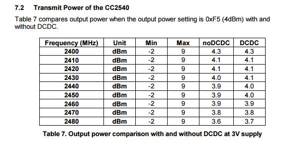

I would like to clarify the deviation on transmit power for each channels
With reference : www.ti.com/.../swra365b.pdf
Table 7.
The min Max staed is -2 to 9dBm, i do not think think this figure is realistic as it is suggesting a 11dBm spread.
Kindly advise
