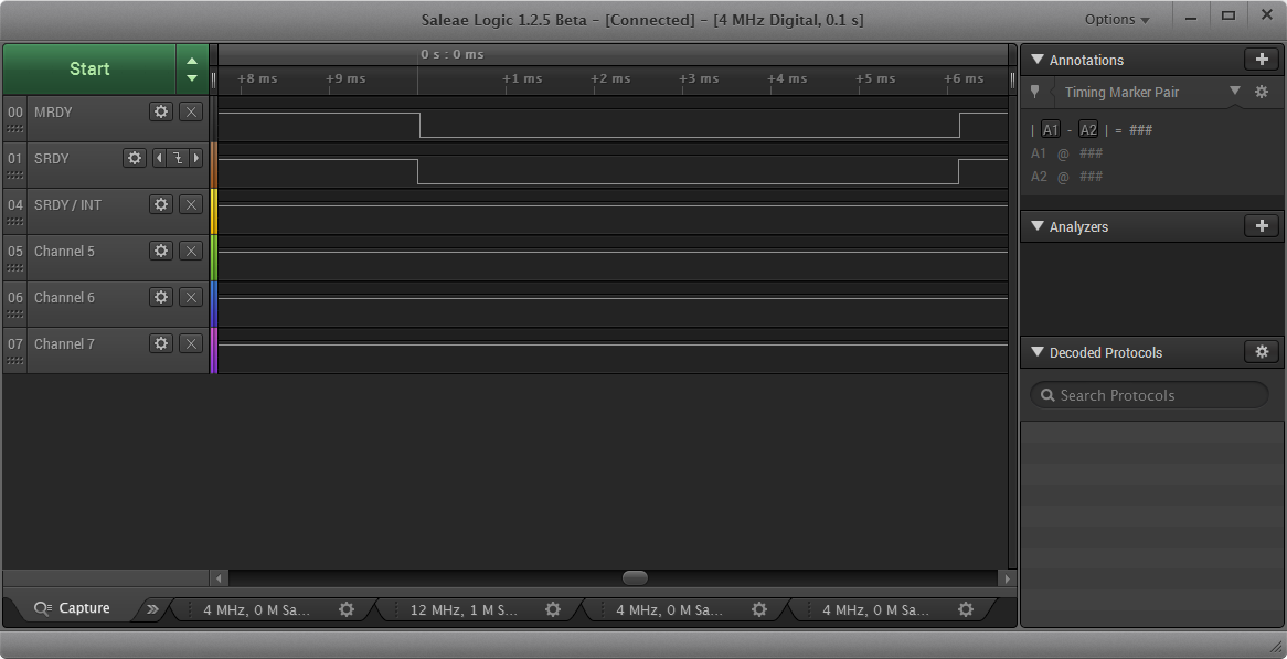

Hi everybody,
We are developing a product where CC2640 is conected by SPI to a main MCU (MKL27 from Freescale). We have implemented NPI over SPI (as described, for example here: processors.wiki.ti.com/.../Cc2640_Adding_a_UART_or_SPI_driver_to_a_Sample_Project) to solve communication between them. SPI/NPI communication is bidirectional: both chips can read and write on bus at any given time (if it is not busy, of course).
We are having some strange problems: communication starts working, but it fails after some minutes (https://e2e.ti.com/support/embedded/tirtos/f/355/p/458078/1654073#1654073). Revising and analyzing TL protocol, we have found some issues we don't understand.
To expose the first one, consider the case when slave (CC2640) writes. The timing diagram documented in in http://processors.wiki.ti.com/index.php/Cc2640_Adding_a_UART_or_SPI_driver_to_a_Sample_Project#TL_Protocol shows that "The data transfer is ended by the master raising MRDY followed by the slave raising SRDY. "
Analyzing the code, we see that raising MRDY and SRDY are independent events triggered by the corresponding callbacks in the corresponding SPI driver implementation of each driver (that is, the driver in the master MCU raises MRDY when it detects transaction finished, and the driver in the slave (CC2640) raises SRDY when it detects transaction is finished).
Moreover, if MRDY raising was detected in the slave side before the transaction is marked as finished in its side (that is also the event that raises SRDY), then the function SPICC26XXDMA_transferCancel() would be called to cancel transaction. So we don't understand that order (MRDY raising before SRDY raising) in that diagram. Also, we have made some captures using a logic analyzer, and we see that MRDY is lowed and raised a few microseconds after the corresponding SRDY edges:
In any case, as said, the raising edges are completely independent in our code. In fact, using a breakpoint we have observed that after some minutes raising MRDY must be happened first, because SPICC26XXDMA_transferCancel() is called to cancel a current NOT NULL transaction.
Could you explain me this issue of the diagram? Should we do something to synchronize in any way the raising edges of MRDY/SRDY? In that case, which of them should be trigered first?.

  • Hi Jose,
    I understand that MRDY/SRDY wording is confusing in our wiki. I will work to update it. This is from our SNP software developer's guide:
    "The timing diagram in Figure 8 shows that MRDY is de-asserted only after the transfer on the serial
    bus has completed. This behavior however, is dependent on which underlying serial bus is being used.
    For SPI, the SNP has no concept of when the SPI transfer has finished because the AP is in control of
    SCLK and determines how many bytes are clocked. It is the AP’s job then to clock the correct amount
    of bytes and then de-assert MRDY which signals to the SNP that the transfer has indeed completed.
    The correct amount of bytes is determined by a length field that is present with the SPI frame that is
    being transferred."
    Though you may not be using the SNP, this blurb applies to the NPI protocol with SPI. Does that clear things up? Regarding your issue from the other E2E thread, I will look into the issue more and comment in that thread.

  • Now that we have established this thread as the one to move our discussion forward on, let me answer your questions.
    1. yes if need be just capture a bunch of transaction. I believe the Salae model is really only limited by how much space you have on your PC. In order for the traces to be reduced in size you can reduce your sampling rate. Always be sure that you're at least ~5x as fast as the SPI clock to get an accurate picture of whats going on.
    2. I understand this may be difficult because of your hardware setup, but it is very very important to root-causing this problem. You could possibly scrape the silkscreen and green wire to these traces until your HW team builds a platform with some testpoints
    3. Correct. Regardless of what transaction type NPI defines that MRDY will always be raised first (before SRDY). I understand that you are not seeing this in your captures, and I believe this could be due to your NPI implementation on your master device (the MKL27). What I mean by the responsibility being on the master to parse the packet is that the NPI SPI format has a length field (SPI packet diagram here: processors.wiki.ti.com/.../File:Spi_format.png). The NPI master must use this length field to keep track of how many bytes they have rx'd and use that to raise MRDY.
    Does this make sense?

  • Hi Sean, Svend,
    At the end, I have captured a bunch of transaction with all SPI signals:
    20151111_1726_fail_at_95M_4_MHz_240_M_Samples.zip
    I have a breakpoint in the SPICC26XXDMA_hwiFxn() function, just when the fail is detected (as a null pointer object->currentTransaction). This breakpoint stops execution aprox. at 21sg. from the start of the capture (as you can see, after this point only MRDY line has activity).
    Could you please take a look to this capture to see if it can help understand what is happening. Of course, I am fully available to any test or explanation about the capture that you need.
    Thank you very much.
    BR
    José Antonio Martínez.

  • Thank you José.
    Looking at the SPI drivers from the 2.11 RTOS. It seems to me that there are a few ways the currentTransaction can be set to NULL:
    1. Opening the SPI driver
    2. Later in the HWI function that you're breaking in
    3. Calling transfer cancel
    4. Memory corruption (doubtful, lets discount for now)
    Also, I cannot yet pinpoint this to being your issue, but it seems like the last transfer which occurred before you broke did not follow the NPI packet format:
    at ~39s:284ms you send a SOF on MOSI. This is the first byte of the current transaction. According to the NPI frame format for SPI, the following byte should be the length byte, which can be between 0-255. You set the length byte to 0x1C (28 in dec), but then send many more bytes. There should be one spi frame (SOF, LEN, payload, FCS) per handshake. This is vital to the NPI protocol working correctly.
  • Furthermore, I haven't taken the time to count them (Salae doesn't offer an easy way to do this), but it looks like you may be sending more than the max allocated NPI buffer per transaction which 270 bytes as mentioned earlier in this thread. In this case, you will call transfer cancel through NPI which will cause your fault.
    To fix your issue:
    make sure that you are only sending one SPI frame per handshake. You must adhere to the frame format described on the wiki you linked to in order for NPI to be useful. That is, after you have transmitted LENGTH number of bytes, the transaction should cancel and you should raise MRDY. If there is still data you need to send, then you will need to start the transaction process all over again.

  • José,
    I agree that there is likely a misunderstanding. What I am saying is that I recognize that your desired payload is only ~20B, but the issue is that you are in fact sending 270B. Sending a payload larager than 270B will cause SPI_transferCancel to be called which will null out your current transaction object, thus causing the crash you're seeing. This is not a bug in NPI, this is in fact how it is designed. I have spoken with the author of the code and confirmed this.
    The developer states that ideally a frame with LEN=20B will consist of this:
    (in order of appearance on SPI lines)
    MRDY/SRDY handshake|SOF| LEN | PAYLOAD | FCS | MRDY/SRDY handshake
    Stated differently, that means, if LEN = 20B then only 20B (plus FCS, SOF, and LEN) will be transmitted in the frame. The fact that you are seeing the 250 extra zero bytes means there is an error somewhere.

  • Hi Sean,
    I have configured a test environment with the following conditions:
    • CC2640 only uses SPI1, where it is configured as a SPI slave, to try to transmit a TL/NPI packet each second. No SPI0 is used nor initialized.
    • MKL27 does not transmit. It is configured as a SPI master, and only reads transmissions from CC2640.
    Then, I observe the following:
    Each time CC2640 wants to transmit a packet it does the following:
    1, It configures SPI_transfer() to transmit 270 bytes (NPITLSPI_writeTransport()):
    // set up the SPI Transaction
    spiTransaction.count = NPI_TL_BUF_SIZE;
    spiTransaction.txBuf = TransportTxBuf;
    spiTransaction.rxBuf = TransportRxBuf;
    // Check to see if transport is successful. If not, reset TxBufLen to allow
    // another write to be processed
    if( ! SPI_transfer(spiHandle, &spiTransaction) )
    2. Enables SRDY: (NPITL_writeTL()):
    SRDY_ENABLE();
    Then, it's the SPI master code on MKL27. Originally, it was configured to read NPI_TL_BUF_SIZE (270) bytes, so, as the master, it generated clock until this amount of bytes were readed, then it raised MRDY to finish transaction. This situation corresponds to the captures already discussed in previous posts, where there is a padding of zero bytes until reaching 270 bytes. From your comments, and the documentation it seems to me that master should use the known TL packet length to raise MRDY when the suitable number of bytes have been received, without expecting to complet 270 bytes, am I right?
    What I have found is that if I change master implementation to read a lower number of bytes (for example 170), then what happens is next:
    1. After MRDY deassertion, clock is generated by master until these 170 bytes are received. As in previous case, zero bytes are readed from the end of the NPI/TL packet until 270 are reached, so I guess this is right, is that true?
    2. NPITLSPI_CallBack() is never called, so SRDY is never deasserted and no more that one transmission can be done. Is this behaviour expected? In that case, I guess that I can not configure master to read only the amount of bytes that corresponds to the NPI/TL packet. It had to read always the same NPI_TL_BUF_SIZE (270) bytes before deasserting MRDY (which is not what I understand from you comments as said before).
    This behaviour can be seen in the following analyzer capture:
    20151119_2022_size_master_150_4 MHz_80_M_Samples.zip
    Could you help me clarify all this mess?. Thanks a lot.

  • Hi José,
    Please revert back to the case where NPI_TL_BUF_SIZE = 270. You should also leave the NPITLSPI_writeTransport() function untouched.
    The basic idea is this, as I have said earlier in the thread:
    1. 1. NPI kicks off a (270 by default, but really this is just chosen to be arbitrarily large) byte read for every transaction on the slave side. This transaction is started with the intention that it will not finish.
    2. 2. Instead of sending out 270 bytes of 0x00 (useless data), the NPI SPI slave expects that the master will
      1. Read the "header" i.e. SOF and LEN fields. The header is always 2 bytes. This means from master POV each frame starts with 2B read.
      2. Based on the header LEN field, it will kick off a read of N bytes, where N is the data within the LEN field (0-255).
      3. Once the payload (LEN = N) has been read, the master will raise the MRDY line.
    Rising MRDY event stops the current transfer on the slave side long before 270 bytes are ever transferred. Please implement this code on your master side and see if you cannot replicate the a similar logic trace to that which is on the wiki.
