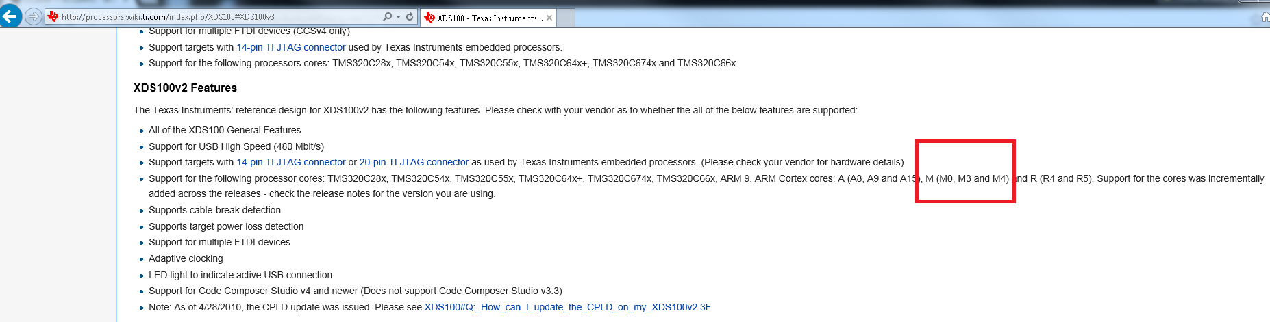

  • HI Tiabo
    I'm a little confused, base on TI wiki I can see the XDS100V2 supporting the ARM Cortex-M3 which is the core of the CC26x0 devices..
    screen-shoot from wiki
  • I understand the confusion. The difference between XDS100v2 and XDS100v3 is mainly that the latter supports 2-pin cJTAG (compact JTAG, IEEE 1149.7). The CC26xx device powers up in 2-pin cJTAG and a special sequence is required to switch into 4-pin JTAG mode.
    I don't have an XDS100v2, but my guess is that it does not support this switching sequence required to get CC26xx to communicate using 4-pin JTAG.
    TIABO

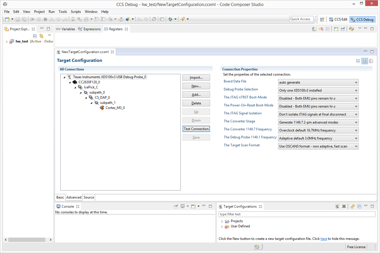

    I have now the XDS100v3 and I having the same error,
    -----[An error has occurred and this utility has aborted]--------------------
    This error is generated by TI's USCIF driver or utilities.
    The value is '-242' (0xffffff0e).
    The title is 'SC_ERR_ROUTER_ACCESS_SUBPATH'.
    The explanation is:
    A router subpath could not be accessed.
    The board configuration file is probably incorrect.
    [End: Texas Instruments XDS100v3 USB Debug Probe_0]
    I am seeing activity with my scope in the pin TDI of the jtag, I was not expecting  a signal there, since this a 2 pin configuration.
    is this is normal?
    I only have connected, TMS, TCK, TVD, SRST_N, GND,
  • The error "A router subpath could not be accessed" may be caused by the device's debug interface being locked. The default configuration for CCS is to try to access the CPU_DAP for debugging, but this will not work if the debug interface is locked. You can try the following:
    In the Target connection view you attached above, for both subpath_0 and subpath_1, uncheck the "custom configuration" checkbox.
    With "custom configuration" disabled, you should be able to launch the target connection file and use Script > CC26xx > MassErase to wipe the chip flash, and unlock the debug interface.
    Let me know if this helps.
