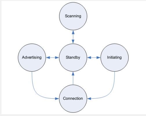

  • Sorry, I'm confused. Doesn't setting GAPROLE_ADVERT_ENABLED to FALSE completely disable advertising rather than disabling for connectable?
    as a BLE device, you have 5 states, in order to make a connection, peripheral device needs to advertising as a connectable device then the Master(your phone) will scan and initialize connect request. So once you turn off advertising, or advertising as non-connectable device, then there is no way to connect.
    if you set it to false, then it's turned off. When you set it to true, then it will be on and advertising.
    GAPROLE_ADVERT_ENABLED--> means it's a connectable
    GAPROLE_ADV_NONCONN_ENABLED--> device will be not connectable.
    if you want to switch it back and forth based on some condition, then just add a if in the program to make it what you want.
