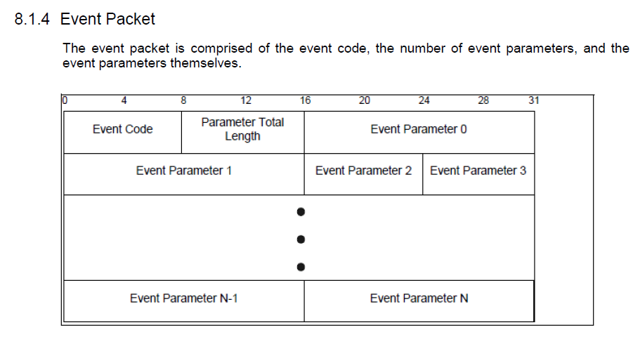

    Still, sending the exact byte sequence as in the PTM wiki: "01 1E 20 03 xx yy zz" (my case 01 1E 20 03 02 02 02)
    and the USB dongle responds with "04 0E 04 00 1E 20 00"  while the wiki mentions it should return "04 0E 04 01 1E 20 00
    Looking at the core spec (v4.1) I decipher the status message as follows:
    • 04 - Status Event
    • 0E - Event type: Command Complete
    • 04 - Num of allowed HCI packets (what is this exactly ?)
    • 00  - ??? Can't figure out ... its kind of 'stuck in the middle...' with no meaning
    • 1E 20 - opcode of the command which caused this event (HCI_LE_Transmitter_Test  command is 1E 20)
    • 00 - return parameter - Success
    Any advice would be appreciated.
    NB - The image was built with CC254x_BLE_HCI_TL_Full.lib
  • From the Vendor Specific API Guide, event packets are constructed as such:
    The 0x0E (command complete event) has the following parameters (from the BT spec):
    So your response should be read as:
    04 - Event
    0E - Command Complete Event
    04 - Parameter Length
    00 - Num of allowed HCI packets
    1E 20 - opcode
    00 - Success
    Regarding the "num of allowed HCI" packets...this is used for flow control from controller to host. It should always return 1.  However, there was a bug in the 1.4.0 stack where it always returned 0 (even though there was actually always 1 command available to be sent).  If this bothers you, I would recommend upgrading to the 1.4.1 stack which always returns 1 here.
