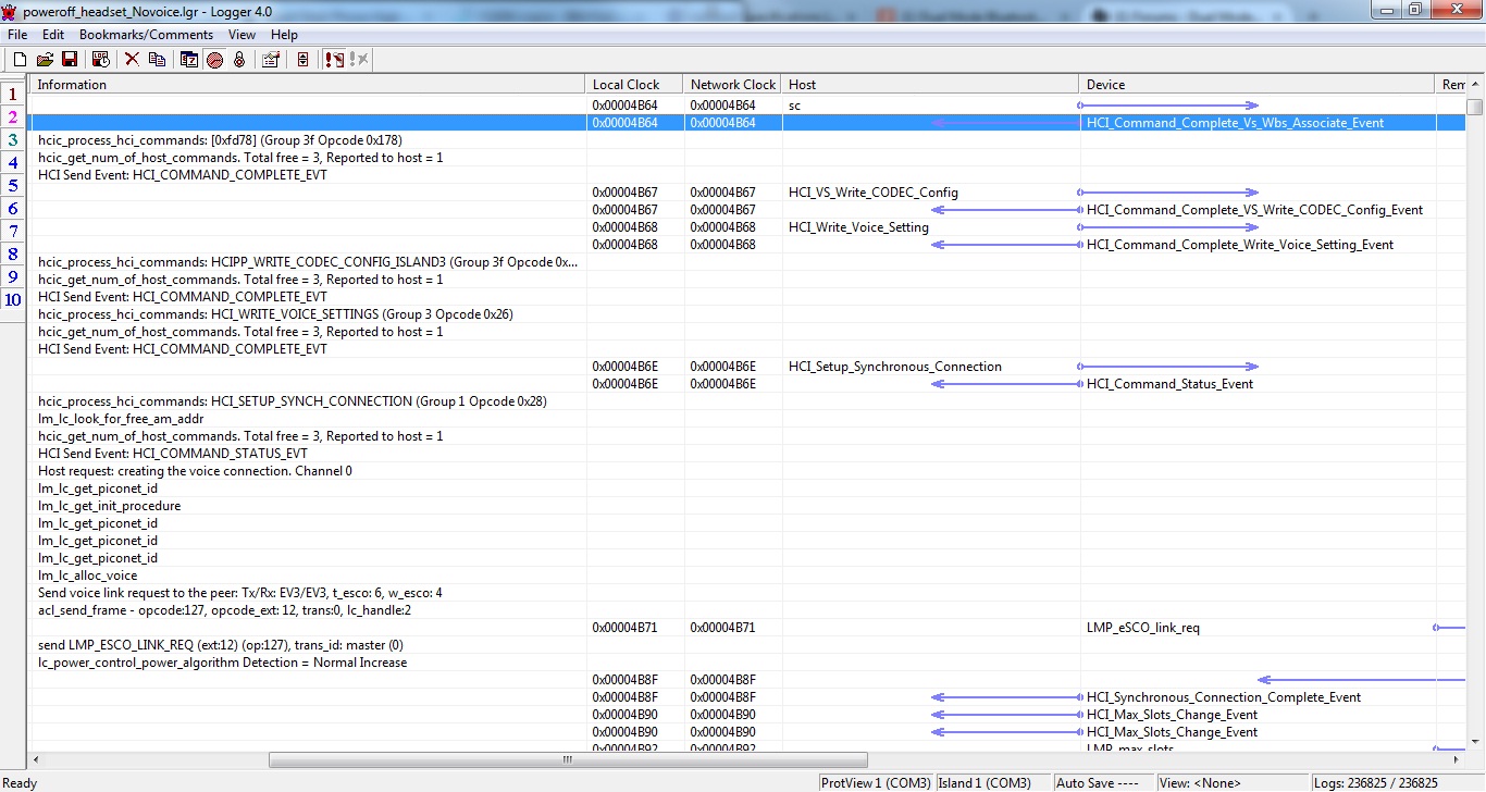

    Max slots is changed due to voice parameters. It's not an issue. Also, it only relates to ACL data packets and has no impact on voice connection.
    Can you take another FW log capture, but this time make sure to enable to protocol viewer check box in the logger utility. It provides additional information such as which parameters are exactly used. You need to have both check boxes enabled (Island 1 and ProtView 1).
    Also, just to make sure, but WBS works for you fine if you don't transit first from CVSD right?

    I found in the log that when there is voice connection setup, there is message as WBS_START and when stop call  there is WBS_STOP after message HCI_DISCONNECTION_COMP_EVT, but there are times for there is no WBS_STOP after message HCI_DISCONNECTION_COMP_EVT. If this happhens, for the next call, there will have message as WBS:received start command even though started already. And in this situation, there will be no voice in the call.
    Is the problem related to WBS start but not stop correctly? Would you help check the root cause?

    The configuration that you're using appears to be wrong. I can't tell for sure what it is, as for some reason not all messages were captured correctly.
    Can you please re-capture again from reset stage. It's important that I see all host <-> controller communication, so please make sure to enable the ProtView check box in the logger utility.
    For WBS, the following (master):
    Send_HCI_Vs_Wbs_Associate 0xFD78, Handle
    Send_HCI_Write_Voice_Setting 0x0063
    Send_HCI_Setup_Synchronous_Connection 1, 0x1f40, 0x1f40, 0xFFFF, 0x0063, Retrans, PACKET_TYPE
    For WBS, the following (slave):
    Send_HCI_Accept_Synchronous_Connection_Request Bd_Addr, 0x00001f40, 0x00001f40, 0xFFFF, 0x0063, Retrans, PACKET_TYPE
    You also need to make sure you loaded the AVPR bts script on top of the bts main script.

    I use CC256xB_BT_Service_Pack_1.2.ili for log tool, but for ProtView, I don't have corresponding HCILib.xml file for CC2564B chip , I wonder wheter it's the reason the logs are not collected correctly.
  • XML files for all products can be found here: git.ti.com/.../xml
    For CC2564B, you will need the file called git.ti.com/.../TIInit_7.6.15.xml

  • Gao,
    Apologies, I'm coming onto this problem late and may need to do some catching up.
    1. In the previous post you said:
    "3. set up call again with handset, no voice now. Release call."
    I suppose by handset you mean the phone? And I suppose here you actually meant to say headset? We can't control the audio from the phone if there isn't a BT/headset connection. Please clarify.
    2. What type of phone is the peer device?
    3. We need an HCI log to get a closer look at the ACL data exchanges between the 2 devices. Please provide a log in the form of a text or excel spreadsheet. For example:
    T0.5 tx packet: 0x01 0x00 .....
    T1.0 rx packet: 0x04 0x00 .....
    or something similar that shows the tx/rx data as well as the relative timestamp.
    4. An air sniffer log would be helpful too.

    We do as the sequence you've mentioned. But for AVPR bts script on top of the bts main script, what does it mean? The sequence in the TIint.bts file can't be updated for it will cause the chip can't be initialized. And it's strange LE is set enabled in the bts file and if we set it disable, the chip can't be initalized too. I put in the stack log and attach the bts file.
    We also tried to use
    U8 vm_audio_enable_AVPR[] = {0x01, 0x92, 0xFD, 0x05, 0x01, 0x00, 0x01, 0x00,0x00};
    U8 vm_audio_disable_AVPR[] = {0x01, 0x92, 0xFD, 0x05, 0x00, 0x00, 0x01, 0x00,0x00};
    before and after WBS start and stop, but it makes other error, for no voice during long call or voice becomes single way during call.
    please help check whether there is problem, thank you very much.
    Gao Hong7103.headsetpoweroff_handsetnovoice.zippltf.zip
    Gao HongTIInit.zip
