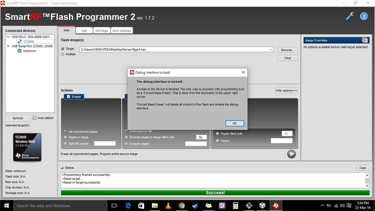

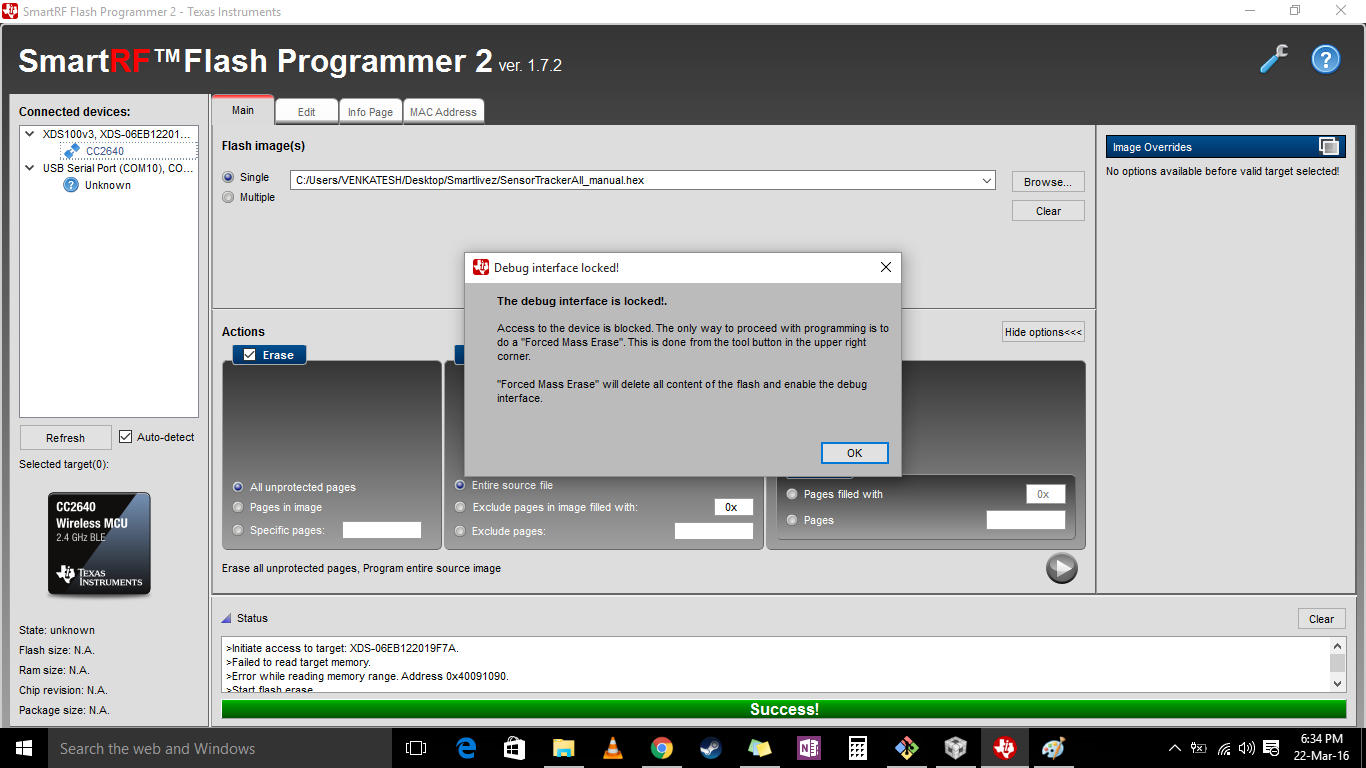

I am using a SmartRF06 board connected via JTAG to our custom board. I have been successfully using CCS to program and debug with this setup for a couple of months, but now the CC2650 appears to be bricked.
When I try using Smart Flash Programmer 2 v1.7.1 to do a Forced Mass Erase, it says that it completed successfully but if I then try to program the device it fails. I have looked at similar posts in this forum but can't find anything that works. Any ideas how to get this chip going again?
Smart Flash Programmer logs:
>>>> Forced Mass Erase
>Initiate access to target: XDS-06EB12202209A.
>Failed to read target memory.
>Error while reading memory range. Address 0x40091090.
>Start flash erase ...
>Erase finished successfully.
>Reset target ...
>Reset of target successfull.
>>>> Erase/Program/Verify with image file
>Debug interface is locked. Aborting action. Only forced mass erase is possible.
>Reset target ...

  • I have done the same thing (Erase all unprotected pages) and have the exact scenario described in this thread (mass erase claims success, but still the device is unreachable). If anyone has a solution it would be very very much appreciated.
  • What's the flash programmer version you have?
  • SmartRF flash programmer 2 - version 1.7.2
  • I would suggest you to ask for replacement from www.ti.com/.../faq-returns-and-refunds.page
  • Can you show me the ccfg file you used to program the device? After you program the device, did you do a reset before connecting to flash programmer? Was there pop-up screen said device is locked?
    CCFG region got corrupted due to a bug in OAD, CCS is unable to access the Core through JTAG.
    Can you please let me know how to recover the JTAG connectivity?

  • Can you try to use flash programmer to see if you can gain access to the device? If yes, try to use mass erase to recover the device
    You can download flash programmer 2 here :
    software-dl.ti.com/.../self_cert_export.html
  • I tried "Forced Mass erase" option using Flash programmer 2, but internal flash is actually un-erased.
    I could see that program residing in CC2650 is able to advertise over BLE.
  • The ccfg file is given below, yes I did a reset before connecting to flash programmer and I don't remember seeing a pop-up screen which said device is locked.

  • Can you show me the screen shot? After erase the flash, do you have access to read the flash content?
  • I could not access the Flash memory region, as Flash programmer is unable to connect to the device.
  • Can you do the following steps and have a screenshot after every steps? Attach all the screen shots when you respond my msg.
    1. Do a mass erase
    2. Power Reset the device and see if the Debug interface locked! msg pops up or not
    3. If no pop-up msg, read ccfg content.
  • here is the error we are facing while Forced Mass Erase.
    >Initiate access to target: XDS-06EB122019F5A.
    >Reset target ...
  • After the Forced Mass Erase followed by the reset of the device again gives the same pop-up asking for Forced Mass Erase.
  • The CCFG file you attached does not have any locked feature... Do you have the Hex files generated for the project?
  • I am uploading both Image-A and Image-B. Image-A is flashed through JTAG and Image-B is flashed through OAD. This problem arrives when OAD is done.
    HexFiles.zip
