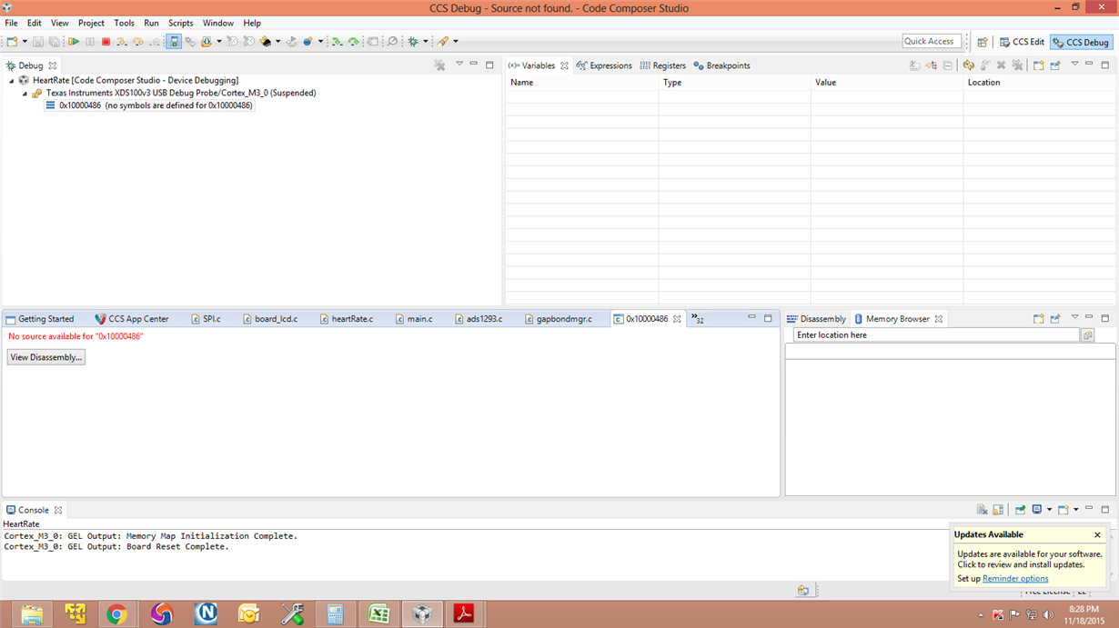

    3) But any time if I want to break the execution, I was getting below message in CCS.

    The reason why there is no source available is because you are likely in ROM code when you hault the processor.
