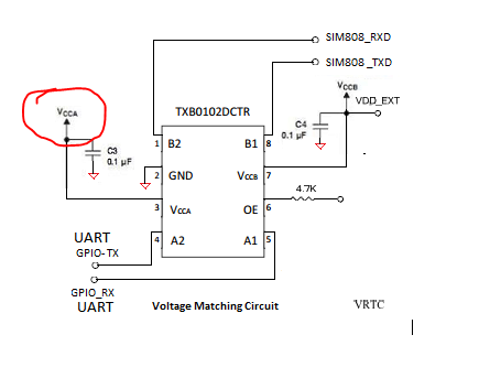

  • Hi Martin,
    Give me your schematic (gsm interface with CC26xx).
    Rajneesh

  • Hi Rajaneesh
    How to enable Vcca since its external supply and

  • hi rajaneesh,
    I have fallowed all your steps mentioned in the previous comment except only one that is Vcca i could not understand how to make it enable and I have initialized modem Tx and RX but i have not connected them to SIM808 in code i have initialized
    6. I have tested 49th pin its giving 3.03v

  • HI,
    Please verify Vcca pin directly connected to Vcc Power supply (+3.3V) then no need to enable this pin.
    Otherwise you have to enable this pin. You can enable pin by using
    PIN_Handle pinHandle;
    PIN_setOutputValue(pinHandle, PIN_Id(pinId), 1);
    Where, pinId indicate IOID no. in your case Vcca pin

  • Hi Rajneesh
    I have connected that Vcca to the VDD of the SmartRF06 i can enable that but the thing is i have not declared all these variables so could u pls tell me what u have declared for these variables

    Above all variables are custom defined according to my board (SIM5320J).
    Board_EN_VBUS and Board_MODEM_PWR_EN used to generate 3.30V
    Board_MODEM_PWR_PGOOD - Just check 3.30 V
    Board_MODEM_CONTROL - Enable GSM Modem by giving (3.3 V) on pin no. 3(SIM5320J).
    Please refer SIM808 datasheet. There are described how to enable gsm modem and AT commands.
    Rajneesh
  • Hi Rajaneesh,
    I have done the changes in my code as u suggested i have enabled VCCA and now the problem is the code is not running its stopped in main.c it didnt not entered BLEpheripheral.c  application only howw to solve this prob
