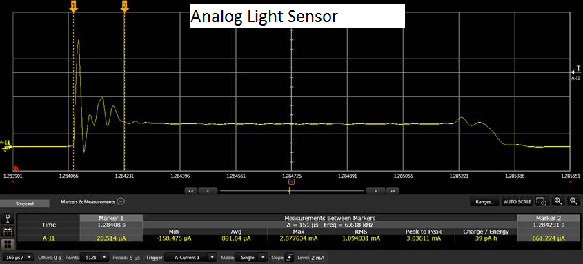

  • Hello Thomas,
    1)
    The sensor controller domain is clocked by the 32 kHz clock during standby when you have set up GPIO event trigger. It takes a few clock cycles for the interrupt to be generated on the chip. During this time the AUX domain is in standby and the current consumption should be in the 1 uA range. Actual wake up and powering of the sensor controller domain (AUX) takes around 150-200 us. I did a measurement on the analog light sensor example (see bottom). This code implement a 1 ms delay during execution.
    2)
    When the sensor controller domain is active there is a baseline current of about 500 uA (due to clocks, power, retention etc). When the processor is running you need to add the processor current as well (8.2 uA/MHz).
    3)
    The power down sequence takes a little more than 100 us as well as seen in the measurement below. Your code will automatically switch back to 32 kHz from 24 MHz when entering standby, while in the example below only 24 MHz is sourced as clock to the sensor controller domain during active mode. The analog light sensor example use the RTC scheduling for wake up and hence does not use any clock while in standby.
    Please note that this was a basic measurement done on my desk on a dev kit and there might be some small discrepancies or inaccuracies.
