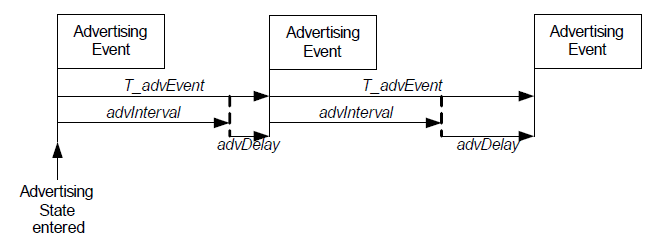

    A small question:
    So when I am advertising every 20 ms, would the scanner get the packet every 20 * 3(channels) = 60 ms because the advertiser is transmitting on 3 different channels while the scanner is scanning only on one channel?
    or that the advertiser is advertising within 20 ms on the 3 channels so the scanner will get it every 20 ms and not every 60ms?
    Thanks.
  • An advertising interval of 20 ms means that the advertisement will be sent on all three channels every 20 ms. That is, this will occur every 20 ms:
    Please read through the relevant sections of the spec for more information.
    Also note that duplicate received advertisement packets are filtered out at a lower layer of the stack so you will only receive one of each advertisement report in the application when advertising finishes.
