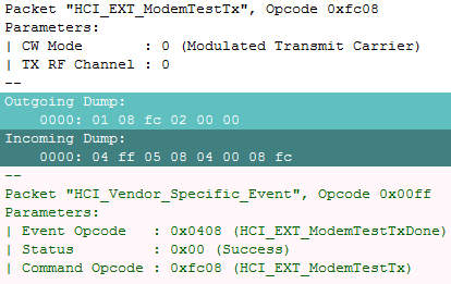

[cc2541] Is that possible to run HCI_EXT_ModemTestTxCmd with uart in PTM
Other Parts Discussed in Thread: CC2541
I set the cc2541 device PTM
 processors.wiki.ti.com/.../PTM
It works.
I want to run modulation command (HCI_EXT_ModemTestTxCmd) in PTM
so I did send bytes with uart
01 08 FC 02 01 01
     01          device?(I guess)
     08 FC    HCI_EXT_ModemTestTxCmd
     02          data length
     01          unmodulated
     01          channel
when i send those byte to device, device return these bytes(below).
04 FF 05 0B 04 00 0B FC
is that proper result?
or
Is that possible to run HCI_EXT_ModemTestTxCmd with uart in PTM?
