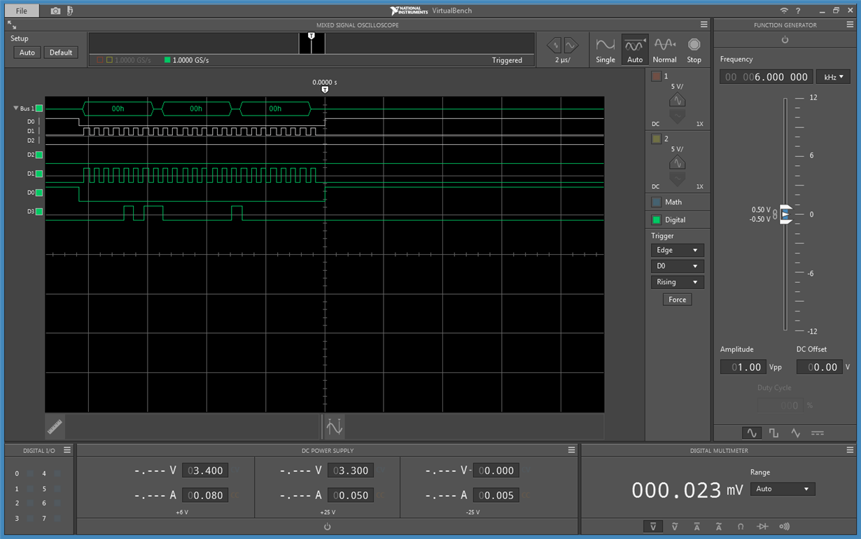

I am trying to interface ADXL362 with CC2650 SmartRF06EVB which is having CC2650-5XD module. I made changes in the board.c and board.h files and initialized SPI handle using SPI_init() and SPI_transfer() functions.
The loop back mode worked and then I tried sending data to ADXL362.  Using the logic analyzer, I can see the data being transferred from CC2650 and I wanted continuous clock for SPI mode of operation, because of which i changed the mode to SPI_POL0_PHA1.   As per the ADXL data sheet, the CS line is pulled low  before transfer and this happens fine. But ADXL is not responding, even the clock and baud rate is same as the one we used for interfacing with another micro controller. The same ADXL works with K53 micro controller which rules out the possibility of  faulty ADXL.
The SSIO_DR register remains at 0x00 throughout.  Is there something which needs to be added in the code for SPI to get it working?
Please help me out..
I am attaching the code snippet below.
The hardware connections are
