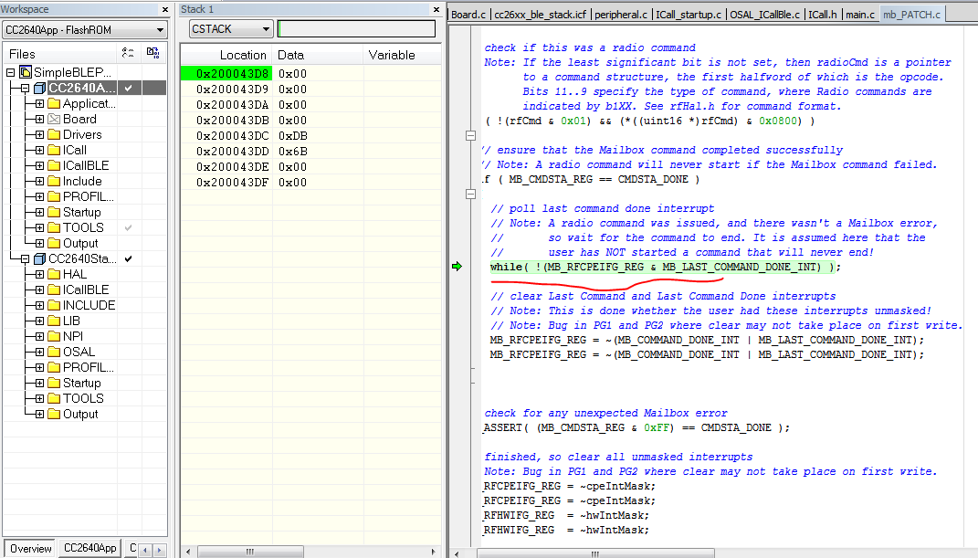

The firmware runs untill ICall_createRemoteTasks(); and stops there.
In assembly debug it just goes between those:
0x1001bbd6: 0x2a00 CMP R2, #0
0x1001bbd8: 0xd0fd BEQ.N 0x1001bbd6

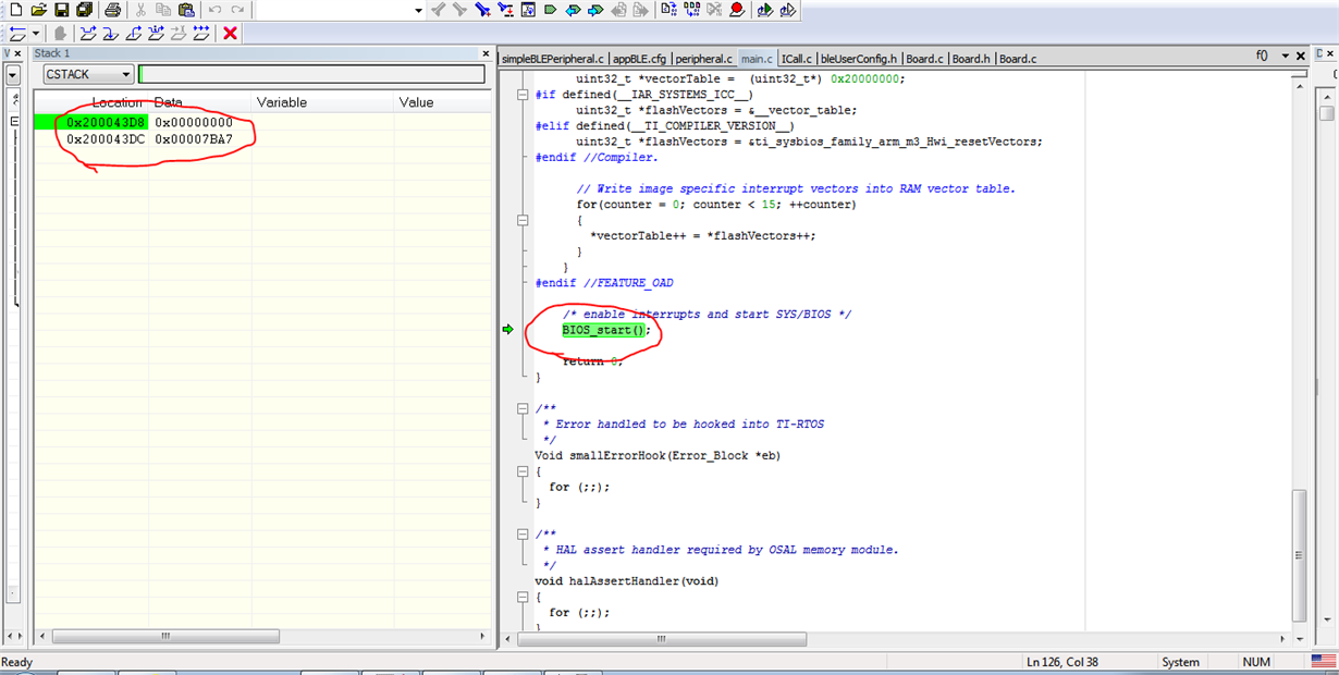

Snapshot :
You can see the address of stack After BIOS start. When I break debugging it show me CSTACK warning with 0x20001918. And
GAPRole_createTask();
SimpleBLEPeripheral_createTask();
Both tasks are pend in semaphore Its not invoked.
