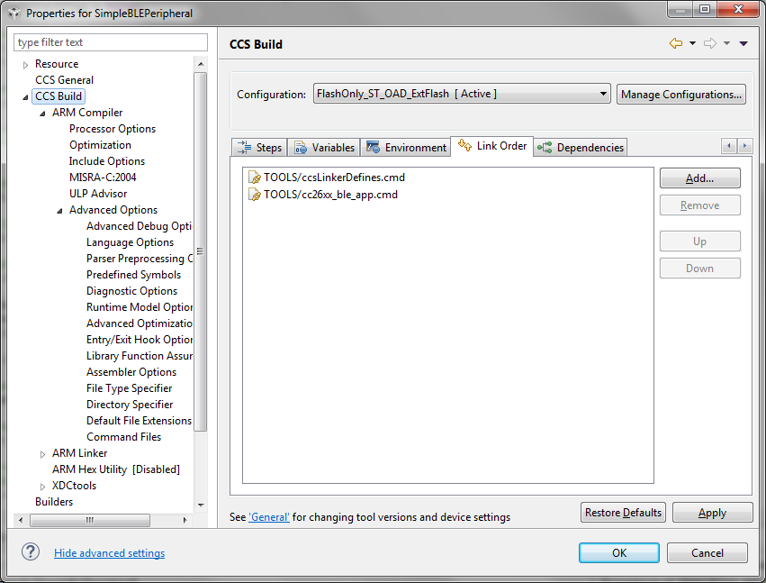

I noticed that the link order for the SimpleBLEPeripheral FlashOnly_ST_AOD_ExtFlash build configuration does not reference the cc26xx_ble_app_oad.cmd file but rather the cc26xx_ble_app.cmd file as shown in the screen shot:
The project does build with the correct file (cc26xx_ble_app_oad.cmd) as shown in the Project Explorer window and per the addresses in the .map file. So does it matter what's shown in this window? Also, what does ccsLinkerDefines.cmd do versus ccsCompilerDefines.bcfg (they both define ICALL_STACK0_ADDR)?
  • Yes, it matters what is shown in this window. ICALL_STACK0_ADDR needs to be defined both places due to a compiler limitation. From the software developer's guide..."Due to a limitation of the IAR & CCS linker, ICALL_STACK0_ADDR must also be defined in this file to the same value as the linker config file. This file is located in the TOOLS IDE folder and updated by the Boundary tool when an adjustment is required."

    The screenshot I posted in the question was what I got when I set the SimpleBLEPeripheral to the FlashOnly_ST_OAD_ExtFlash build, so it seems to be an error in the example project...
    Anyhow I fixed that, but I also found the following issues:
    1) In cc26xx_ble_app_oad.cmd, the following is coded: FLASH (RX) : origin = APP_BASE, length = ICALL_STACK0_ADDR - (APP_BASE + PAGE_SIZE) - 1. However this seems to waste a page. Shouldn't this simply be FLASH (RX) : origin = APP_BASE, length = ICALL_STACK0_ADDR - (APP_BASE) - 1.Why is length reduced by an extra page? You can see from the following map files that one page in flash is wasted:

    0x1000+0xbfff=0xcfff, but the stack starts at 0xe000, so it seems that a page is wasted in the OAD build.
    2) In the hexmerge call in the SimpleBLEPeripheral post build:
    python "C:/Python27/Scripts/hexmerge.py" -o "${PROJECT_LOC}/FlashOnly_ST_OAD_ExtFlash/OAD_IMAGE_FULL.hex" -r "1000:1CFFF" --overlap=error "${PROJECT_LOC}/FlashOnly_ST_OAD_ExtFlash/${ProjName}.hex":1000:EFFF "${PROJECT_LOC}/../SimpleBLEPeripheralStack/FlashROM/SimpleBLEPeripheralStack.hex":F000:1CFFF
    SimpleBLEPeripheral.hex ends at 0xcfff but the merge chooses 0xefff as the end address. Also SimpleBLEPeripheralStack.hex uses the wrong start and stop addresses.
    3) I'm unclear on the origin for SimpleBLEPeripheralOAD.out starting at 0x1000, but the OAD User's Guide says to set M3Hwi.resetVectorAddress = 0x00001010;. I confirmed that the starting address is indeed 0x1010 by reading the flash contents. Why is this not starting at address 0x1000?
    Please comment on these issues as they are found this way in the SimpleBLEPeripheral example. Thanks!

  • There shouldn't be any issues in the default sample project. If there are, I will look into them. Are you using the 2.1.0 installer? And are there absolutely no changes to the sample project?
  • Hi Tim,
    There are no changes and I'm using the 2.1.0 installer. I'm using CCS not IAR. There's another thread in this forum that says that the IAR compilation of the BLE stack uses less flash, and that's where this discrepancy is coming from. You'll want to update the OAD guide and SimpleBLEPeripheral project if so.
    How did you replace the cc26xx_ble_app.cmd by cc26xx_ble_app_oad.cmd in the list, as mentioned in the user's guide?
