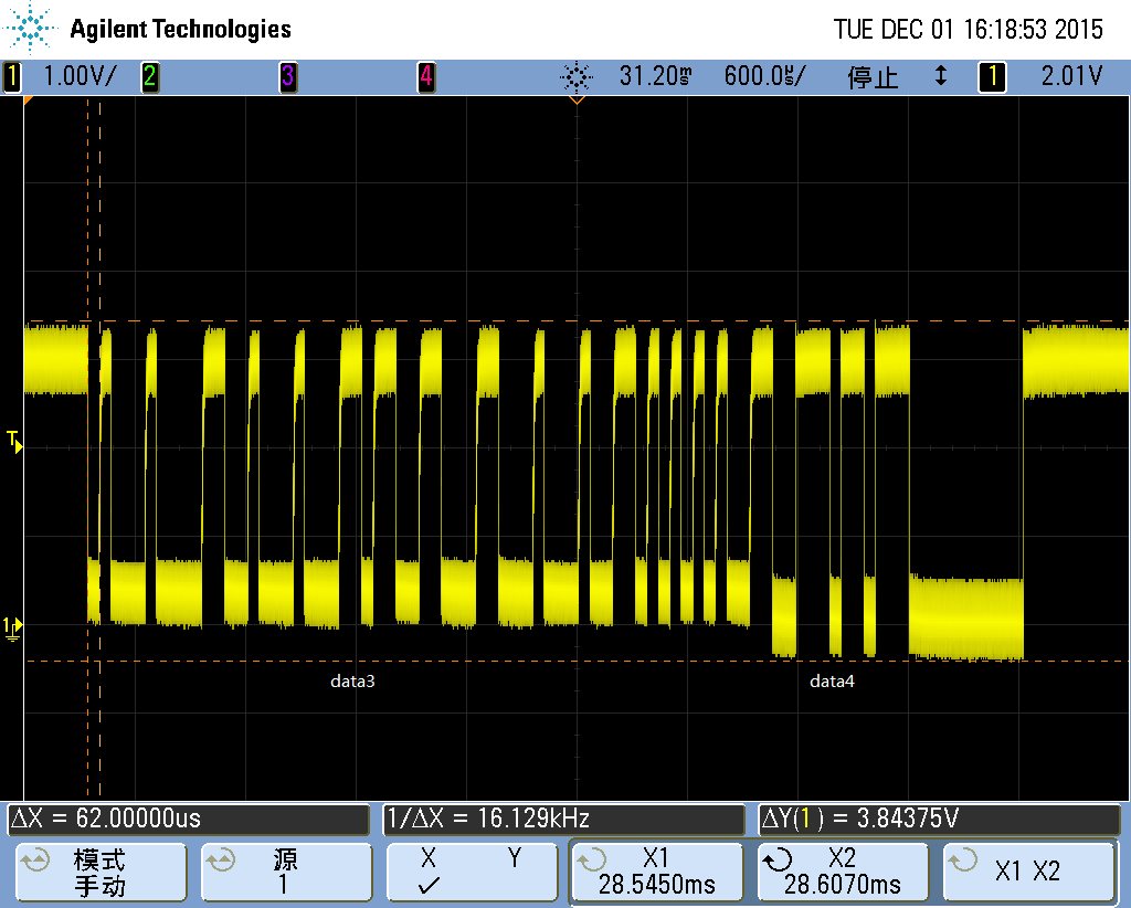

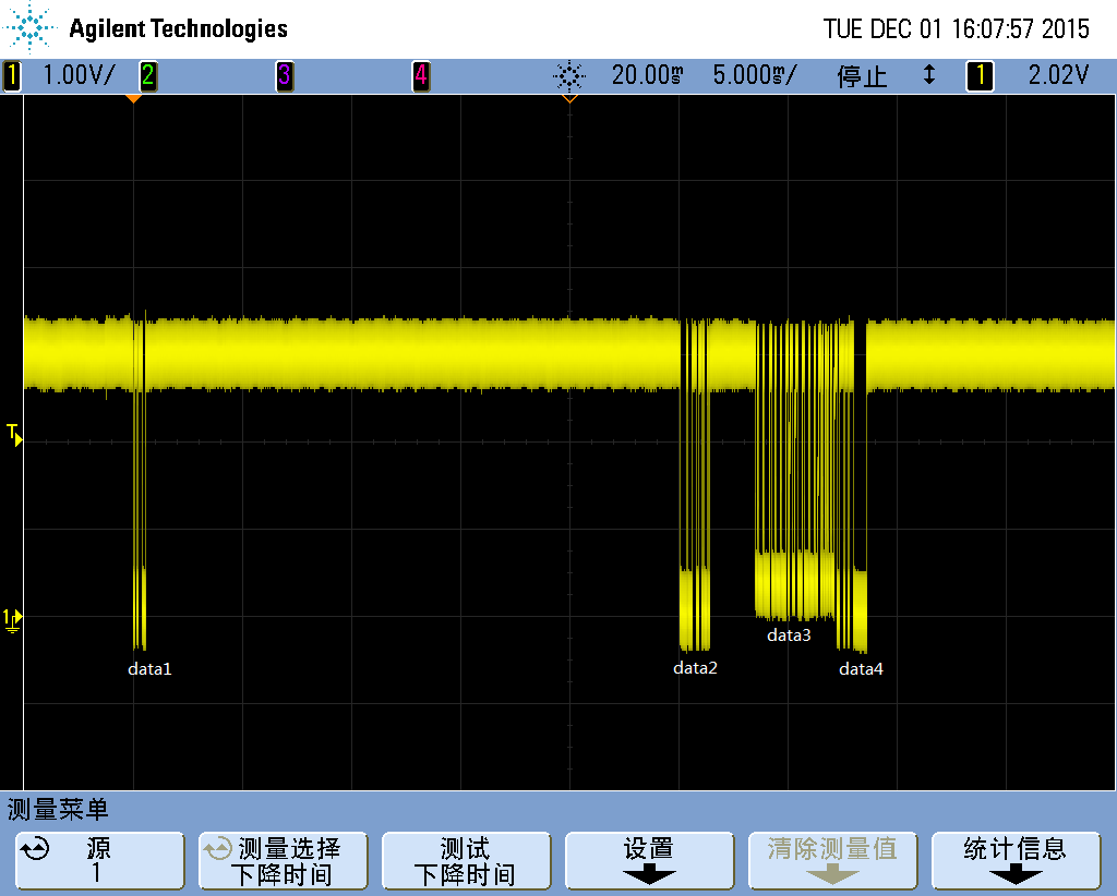

  • Hi svendbt,
    There is another test, the transaction is shown in following oscillogams. In this test the other MCU responsed 6E00 instead of 6677.
    The oscillogram 1 shows the full transaction, there are four pieces of data. The data1(0x3B) and the data2(0x10,0x96) is the init data(3 bytes) from the other MCU. Then the CC2650 sends data3(0x11,0x22,0x33,0x44,0x55) to the other MCU. The data4(0x6E,0x00) is the response from the MCU to the CC2650.
    The oscillogram 2 shows the data3 and data4 by zooming in. We can see the baud rate is 16129bps. Also, I'm sure we used common ground.

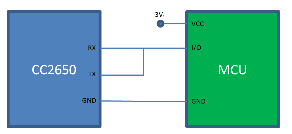

  • We connect the CC2650 with the other MCU as follow.
    When the TX was sending data, it seems that the RX FIFO buffer received them at the same time.
  • Hi Kang,
    The fact that you are shorting RX and TX would be a good idea to explain in the original post.
    When you do this the TX from CC2650 will drive the line high when it is not transmitting so when the MCU tries to send data you will have very high current draw and the devices can potentially reset due to this or you can get corrupted data. You might get around this by using open-drain IO mode on both sides with a pull-up externally the way a I2C bus works.
    The issue you are seeing is expected behavior. From the "Power management" chapter in the UART driver documentation:
    After a successful UART_read(): The device is allowed to enter standby, but RX remains on.
    • Note: Device might enter standby while a byte is being received if UART_read() is not called again after a successful read. This could result in corrupt data being received.
    • Note: Application thread should typically either issue another read after UART_read() completes successfully, or call UART_readCancel() to disable RX and thus assuring that no data is received while entering standby.
    Documentation for this can be found here: C:/ti/tirtos_simplelink_2_13_00_06/docs/doxygen/html/_u_a_r_t_c_c26_x_x_8h.html
    Svend
