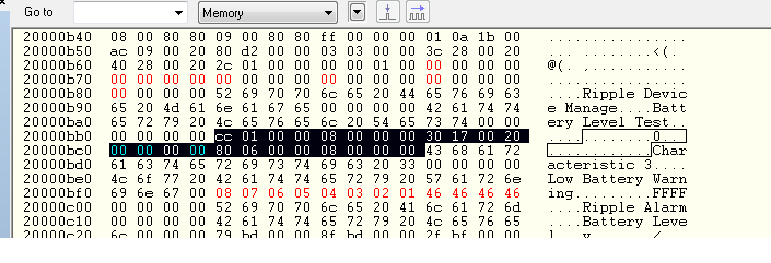

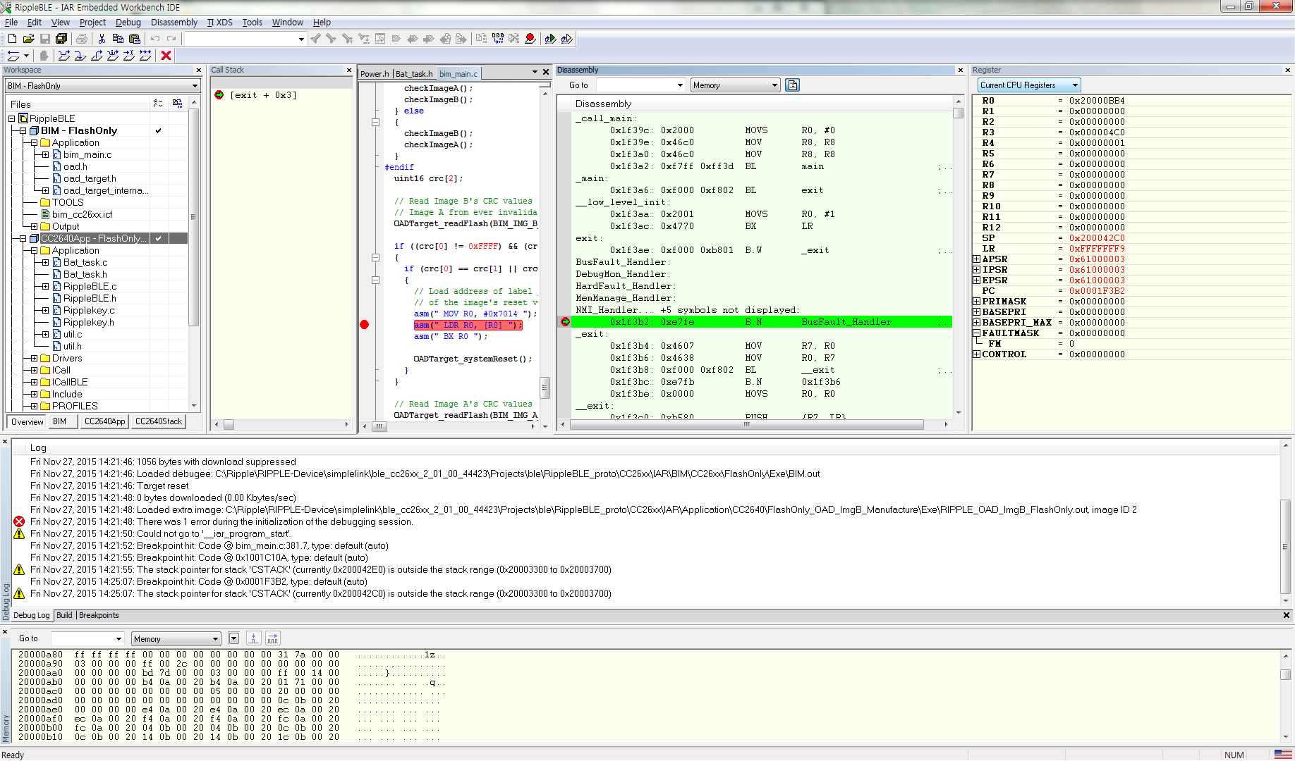

Here is screen capture images from IAR IDE.
Bus fault exception is occurred on Boot ROM area.
Because R1 register is 0x00000000.
Image #1 shows R1 register is 0x000000, Value for R1 is 0x00000000 on SRAM area (please refer to bottom memory area on #1 image)
I think that is the reason why exception is occurred.
For the reference, Image #3 show some value is loaded on R1 register. Therefore, there is no exception occurred.
It is just happened by adding/removing code above.
I have no idea why boot code can't load a value properly according to SRAM code area is changed by adding code.
Please, give me any comment. it will be very helpful.
If you need more information, please let me know.
Thanks in advance
<#1. Before but fault exception>
<#2. but fault exception>
<#3. No exception>
    Have you modified bim_main.c? Did you confirm that the address of __iar_program_start is at the location referenced in the asm code?
    Best wishes
  • Hello JXS,
     Yes, I changed address in bim_main.c. Also It looks OK.
     For your reference, I captured related things about  __iar_program_start.
    < bim_main.c>
    < memory dump>
    <Mapfile>
  • I add more information.
    It look some memory space is overlapped.
    In my first comment, it is refered 0x20000bb4 either exception and no-exception situation.
    It looks that  try to refer to data in <appBLE_prm3.orm3>
    But, in case of exception situaion, it looks that refer to wrong address.
    That's the reason why load value on R1 is 0x00000000. As a result, exception is occurred.
    It looks i missed something.
    Please guide me to fix this situation.
