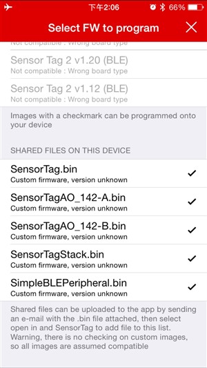

I followed CC2640 BLE OAD User's Guide to implement OAD function on CC2650, according to chapter 9, I have generated OAD_IMAGE_FULL.hex and BIM_ExtFlash.hex successfully, however, I couldn't download and copy images neither with BLE monitor nor Multitool app on my iPhone 6.
And it always shows "FW upgrade failed, Device did not disconnect after programming as it should. Firmware upgrade failed, you should check battery and settings".
I know it's not the battery problem. Because there is few people discuss the off-chip and CCS built issue, I cannot find any suggest works on mine problem, please help me.

    Another question, I use SensorTagAO_142-A.bin to upgrade the old firmware,but the application I used is SimpleBLE peripheral, is that okay?
    Thank you for your reply,
    Wei

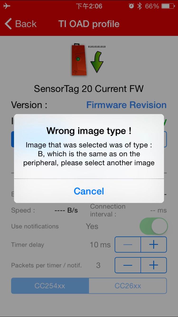

  • Hi Wei,
    Youre using a sensortag bin file as your application? This will not work as I mentioned above because the sensortag app and the SimpleBLEPeripheral app use a slightly different OAD process. Also you can only OAD images of the same type as your original resident image.

  • Sean2,
    I selected SimpleBLEperipheral.bin to upgrade FW, however it shows message that I cannot use the file.
    Do you have clear indication for upgrading FW with off-chip case?
