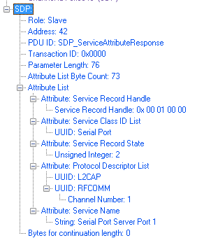

  • Hi GLC,
    [Q] I tried with this function but the client is not able to discover the port number to connect with.
    [A] This is very weird. Are you doing "Open <port>" on the SPP Demo sample app? I just tried it , and I could get the below response:
    As you can see, it is returning channel number "1".
    [Q] I need to connect to a port number with a certain UUID assigned while the function mentioned above doesn't pass any UUID because the SDPservicerecord passed is nul. How can i pass it?
    [A] This is because the SPP service has a standard UUID (Service Class ID) = 0x1101
    You can also take a look at: SPP_Register_SDP_Record
    Gigi Joseph.
