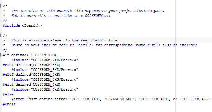

  • 1 ) I can't find CC2650EM_4XD ,there are only CC2650EM_7ID\CC2650EM_5XD\CC2650EM_4XS in SRF06EB folder.So i copy CC2650EM_4XS to SRF06EB folder,and rename CC2650EM_4XD.Morever,i modify board.c file in SRF06EB folder as follow:
    #if defined(CC2650EM_7ID)
    #include "CC2650EM_7ID/Board.c"
    #elif defined(CC2650EM_5XD)
    #include "CC2650EM_5XD/Board.c"
    #elif defined(CC2650EM_4XS)
    #include "CC2650EM_4XS/Board.c"
    #elif defined(CC2650EM_4XD)
    #include "CC2650EM_4XD/Board.c"
    #else
    #error "Must define either 'CC2650EM_7ID', 'CC2650EM_5XD', 'CC2650EM_4XD', or 'CC2650EM_4XS'. Please set include path to point to appropriate CC2650EM device"
    #endif
    and define CC2650EM_4XD.But it still not change TX power.
  • Hello user,
    Look in "bleUserConfig.c" which is located in the app project under the ICallBLE group. Make sure the following table is used for your device:
    const txPwrVal_t txPowerTable[] =
    { { TX_POWER_MINUS_21_DBM, GEN_TX_POWER_VAL( 0x07, 3, 0x0C ) },
    { TX_POWER_MINUS_18_DBM, GEN_TX_POWER_VAL( 0x09, 3, 0x0C ) },
    { TX_POWER_MINUS_15_DBM, GEN_TX_POWER_VAL( 0x0B, 3, 0x0C ) },
    { TX_POWER_MINUS_12_DBM, GEN_TX_POWER_VAL( 0x0B, 1, 0x14 ) },
    { TX_POWER_MINUS_9_DBM, GEN_TX_POWER_VAL( 0x0E, 1, 0x19 ) },
    { TX_POWER_MINUS_6_DBM, GEN_TX_POWER_VAL( 0x12, 1, 0x1D ) },
    { TX_POWER_MINUS_3_DBM, GEN_TX_POWER_VAL( 0x18, 1, 0x25 ) },
    { TX_POWER_0_DBM, GEN_TX_POWER_VAL( 0x21, 1, 0x31 ) },
    { TX_POWER_1_DBM, GEN_TX_POWER_VAL( 0x14, 0, 0x42 ) },
    { TX_POWER_2_DBM, GEN_TX_POWER_VAL( 0x18, 0, 0x4E ) },
    { TX_POWER_3_DBM, GEN_TX_POWER_VAL( 0x1C, 0, 0x5A ) },
    { TX_POWER_4_DBM, GEN_TX_POWER_VAL( 0x24, 0, 0x93 ) },
    { TX_POWER_5_DBM, GEN_TX_POWER_VAL( 0x30, 0, 0x93 ) } };
  • 1、i use rsm 4*4 chip.if i want to use 5dbm tx power, Should I use4xd schematic design or 4xs schematic design or two design can be?
    2、My board use 4xs schematic design,then i define CC2650EM_4XD,but i can not set 5dbm.why?
    3、I want use 5dbm,what needs to be modified in addition to defining CC2650EM_4XD ?
  • See your other post as well
    "For a single ended output (like CC2650EM-4XS) the maximum output power is 2 dBm. For a differential output (like the CC2650EM-4XD) the max output power is 5 dBm. See more processors.wiki.ti.com/.../CC26xx_HW_training_RF_Frontends_and_Antennas.pdf"
    To get 5 dBm, you need a differential front-end config with a balun, with a single ended front-end config, the max output power is 2 dBm. To make your new design, you can copy our CC2650EM-4XS for every pin except the two RF pins and the RXTX pin. For the RF part you copy the design from either the 7ID or 5XD desgin, the only difference between these two designs are that the 5XD has external biasing and will give a 1dB better sensitivity. Both the 7ID and 5XD designs can deliver 5 dBm output power.
  • thanks. For firmware,What are the places need to modify?
  • If you have a single ended front-end configuration in HW, you will not get 5 dBm no matter what you do in FW, your FW must match the front-end configuration you have on your board. To change the front end configuration, this is described in many different e2e post for instant
