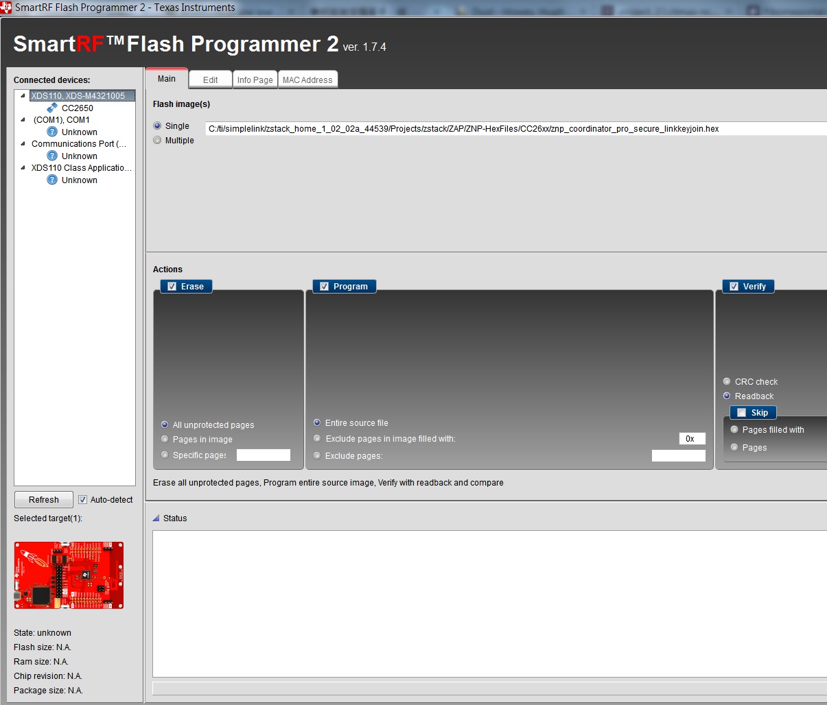

I am having an XDS110 Rev 1.2 debugger purchased along with the cc2650 sensor tag and a smartRF06 EVB with 7ID,5XD,4XS packages of cc2650. I am trying to flash the CC2650-7ID plugged on to the SmartRF06 EVB using XDS110 debugger.  As per the smartRF06 user guide, for connecting an external debugger,
  • removed the P408 (XDS100V3 bypass headers)
  • inserted the current measurement jumper P503
  • Connected the XDS110 debugger to the P410 10pin arm cortex header
  • In the simple BLE peripheral project, under the debugger options , chose debugger as TI XDS110
When the download button is clicked, the following message pops up

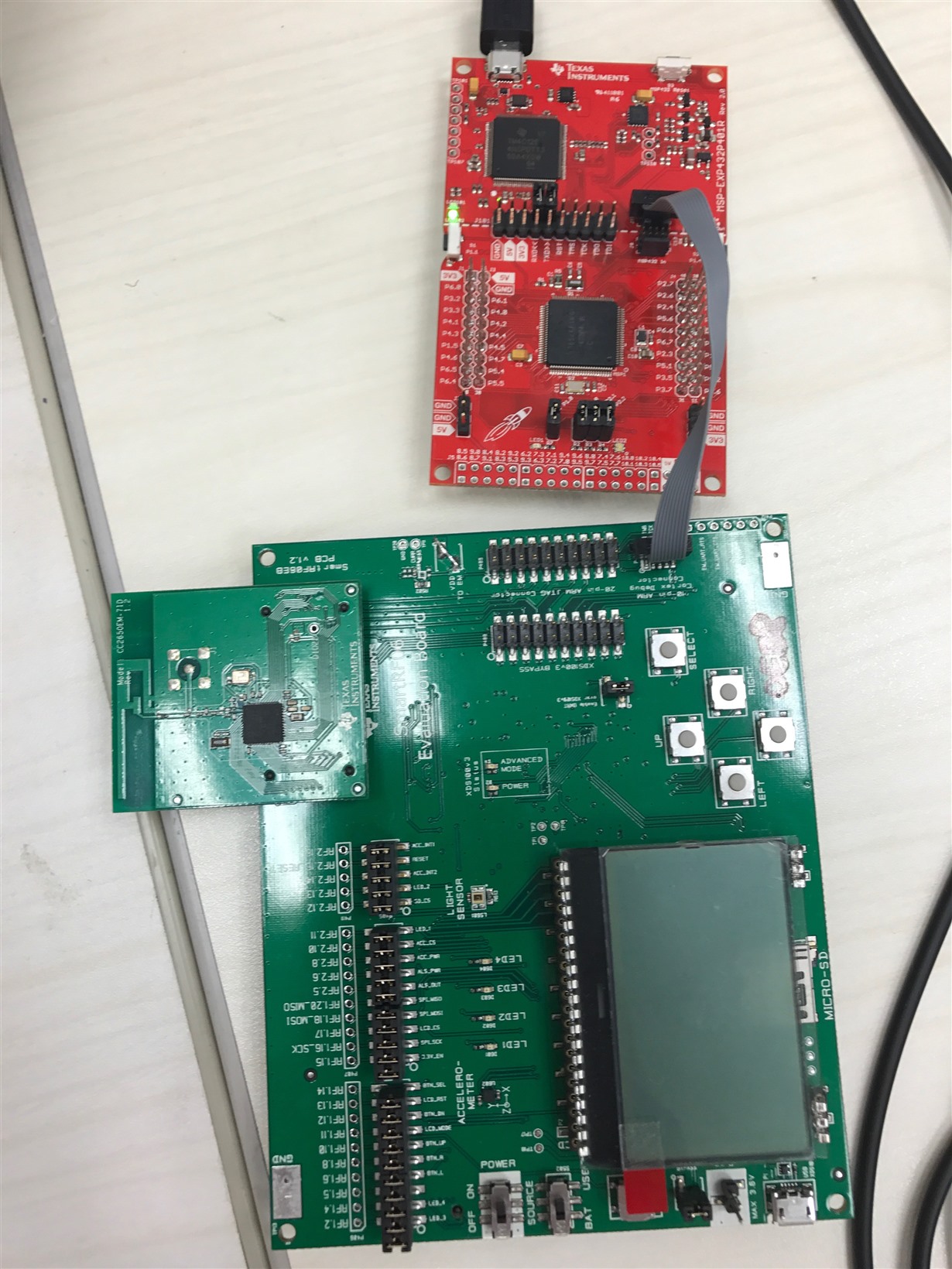

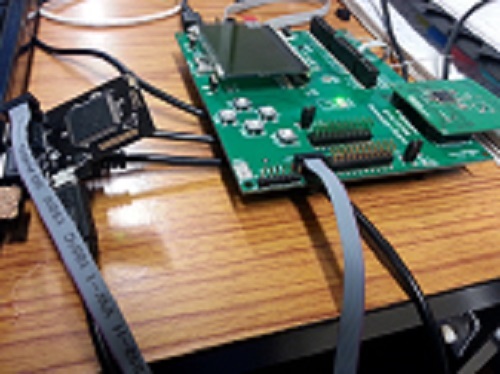

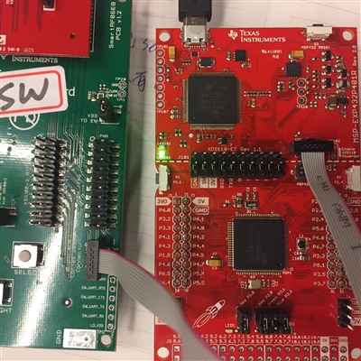

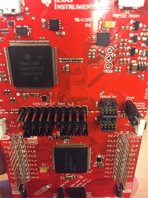

Is there any other configuration that needs to be done? I cross checked the 10 pin header in XDS debugger and SmartRF06 EVB. Even though VDD is not there in the debugger header, EVB is getting powered as the POWER leds are ON.
Please let me know what I am doing wrong. We are planning to use the XDS110 debugger for the custom board being developed using CC2650 5XD and 4XS packages.
A snapshot of my set up is also attached
