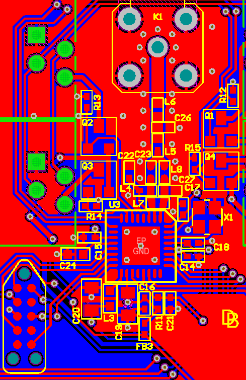

Hi, I have designed a custom PCB with a CC2650 on it. It is based on the Sensortag an other reference designs, the CC2650 part is rather standard, except that I do not use a 32KHz crystal. This is the schematic:
The problem is that the CC2650 is not recognized by programmers. I tried using a XDS100V3 and the debug devpack from the sensortag, both give error 275: JTAG timed out. I checked the DCOUPL, VDDS and VDDR voltages, they are all as they should be. The current draw of the processor with no programmer attached is also 5-7mA, as it should be (probably the bootloader). Does anyone have a clue on what is going on?
