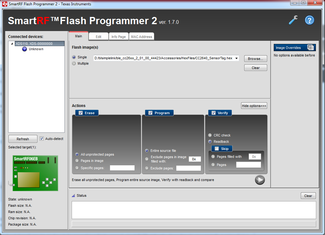

  • I am connected in the same way to the DevPack and to the board as I am used to debug & program using the CCS, I disconnected from the CCS so the DevPack is not used by it and I disconnected all the connections and reconnected again...
    as you see in the upper left corner it show "Unknown" device!
    again, can we program using the DevPack? or we need another board?!
    Thanks.

  • Great,
    I updated the flash programmer 2 on my Laptop and now I can select the hex files and to program them successfully!
    but it does not run! I am sure that these files should make the board advertise and I can see with the sniffer when I program them via the CCS, but there is something bad even I see that it erases then programs then verifies successfully every one of these 2 hex files!
    I see that it is not advertising!
    So I tried to deselect the "Erase" option because I thought that it erases the hex for the stack and so it does not work!
    I think I should select under the "Program" field a specific address with and to select the option "exclude pages..." maybe to program the stack and the application in 2 different addresses? so where can I fing these addresses if it right what I say or maybe I am not using the tool the right way!
